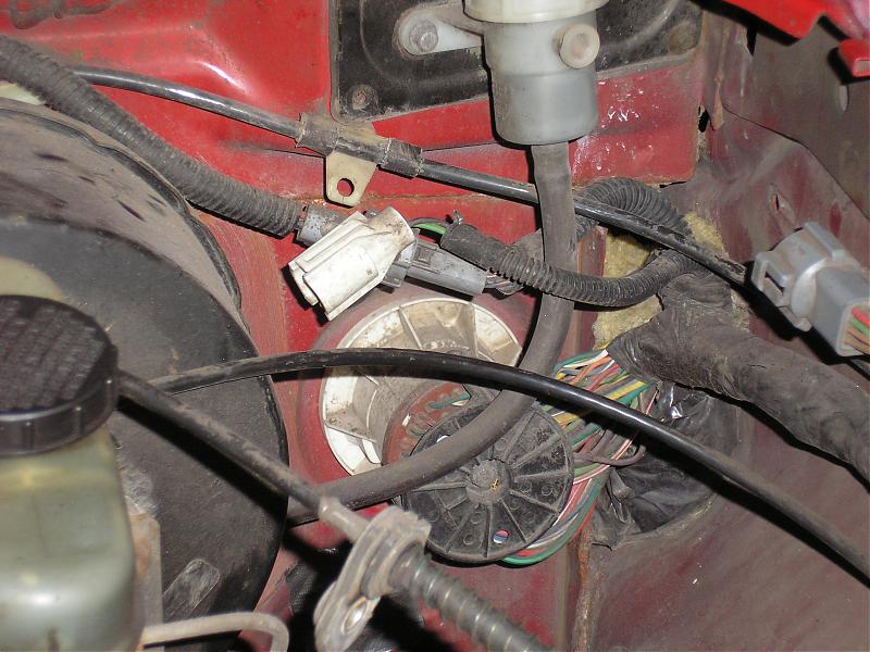

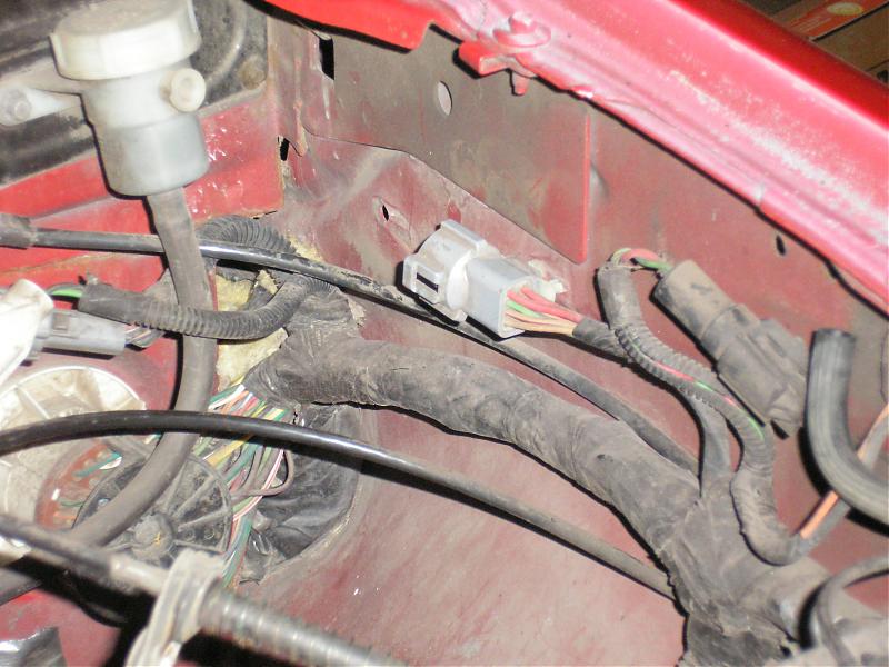

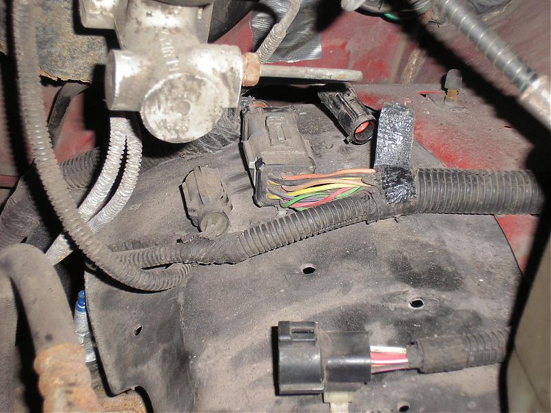

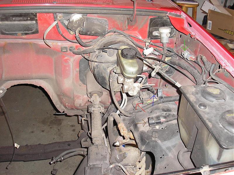

See, what I want to do is "blend" the Mustang harness into some of the plugs on the ranger. I'll have some pics up tomorrow on what plugs I am talking about.
OK, here's some pics. Hopefully one of you guys can help me.

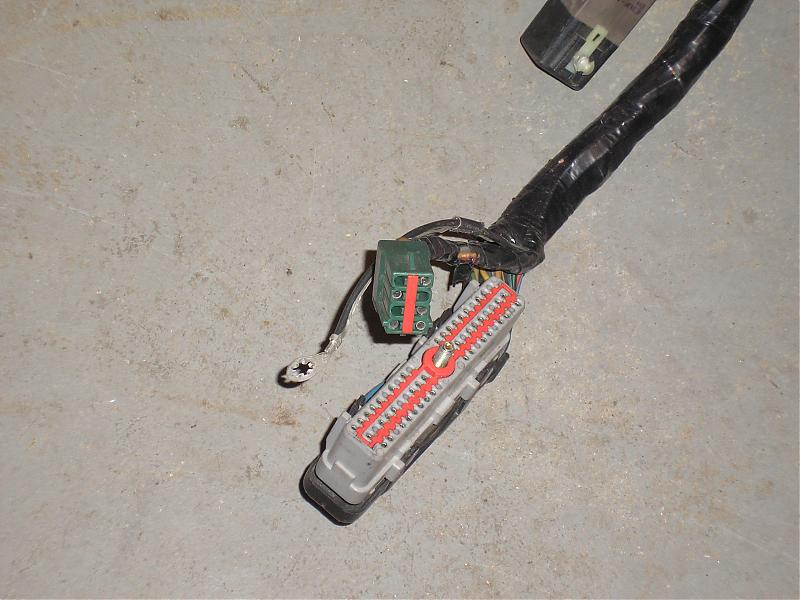

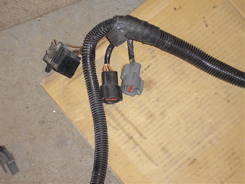

And here's the harness from a Mustang. I got all the other connectors labeled, but I don't quite know what the purpose of these three connectors are. The diagram I had wan't very clear on these three.
Whats the green one for?
The black and grey ones
none of that plugs in if thats what youre thinking
I know that, I wanted to know the function of the plug ins, what their purpose is for.

I asked a while back about this plug (C105F) I checked out dealers and anybody I could think of. If you would run across someone who knew what the pinout for this plug, you would be all set. It would be a pain in the arse though, running down all those wires. Good Luck to you.
P.S if you happen to find the pinout for this plug please post a copy.

Here's another good question:
I still have the fuel injector harness from the donor vehicle(F-150) and it has 8-pin connectors vs. the 10 pin on the mustang harness. It seems to plug into most of the ranger's original harness.
Would it be a better idea to use the f-150 fuel injector harness vs. swapping out the entire thing and trying to figure out every little wire?
I don't think that MAF would be an issue since the plug is on the engine harness.
