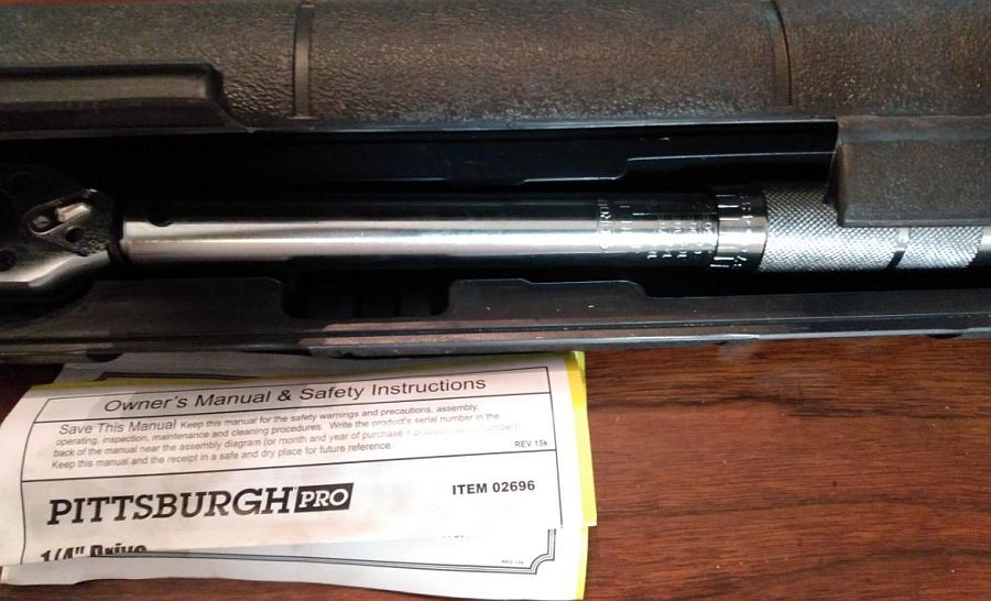

I don't remember ever seeing a dial torque wrench at harbor freight
This is what I bought to put a valve body back on a 5r55e. I wouldn't say it's the finest quality torque wrench ever made, but for what it cost.... it suited the purpose, and is probably about the best one could find for maybe a little over a $20 bill. Also used it to put spark plugs in my son's 4-point-something (4.6?) F150.
It would take a little fiddling with it, to be confident in exactly how much torque is required to turn the pinion.... but I'm guessing it could be done. Anyway like I said, maybe a stupid question, but it came to mind.

The Harbor Freight website states that the lowest setting for that is 20in/lbs, which is probably too high.
A beam style one is still under $25 on Amazon, probably you local parts store too too.
I have that torque wrench. I found it decent for basic stuff. The problem with using that style to set preload is you dont have any indication what force you are applying though. You just have a the click when you reach the torque you set it at. A dial guage torque wrench has no setting it just displays the torque as you apply it. I didn't know if you actually saw a dial torque wrench at harbor freight, I'd go grab one in a second lol.
Nope. Not in that range.
I was just thinking, with the added drag of the main bearings (if the carrier was not removed), maybe the HF wrench would be useful. Just a thought.
You can gauge the rotating drag within the backlash and it will be a little less than the breakaway torque. I'd trust doing it by feel long before I'd trust a $20 torque wrench, I paid $120 for my torque wrench in 1975 when $120 was most of a weeks pay.
