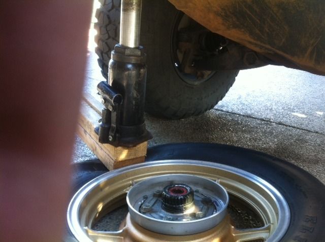

forgot all about this thread... got it unmounted, a small piece of 2x4 worked to get the tire off the rim, once the bead was broken... it was NOT a fun job i'll tell you what...
to break the bead, i tried the long ass board under the wheel of the truck, and prying down on a 2x4 to break it, no dice tried jumping on it, nope, tried putting all my weight on a 2x4 standing up on end, on the bead (i'm 210lbs) no dice...
when i tried prying with the board, i was pushing down on a 8 foot long 2x10, and literally had ALL of my weight on the end of it, and the pivot point only 2 feet from the anchor point, this resulting in wood breaking noises...
i even tried this, this is a 12 ton bottle jack, and i used as many 2x4's as i could to take up space, i basically could squish the tire down the entire distance of the travel on the jack: (keep in mind as i push down, the truck suspension lifts)
what it eventually took to break the bead was this:
with the high lift, i actually lifted one of the back wheels off the ground, before the bead started to move
