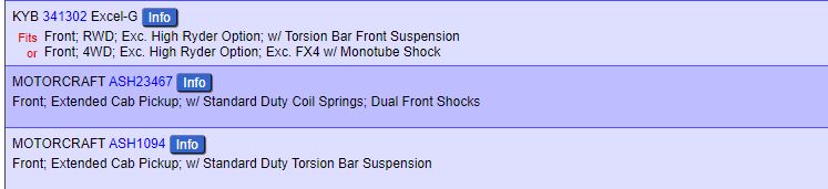

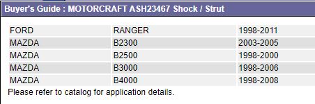

Which Ford Ranger do these shock absorbers fit, please?
FOMOCO website says they are incorrect for my 2005 STX with front coil suspension.
I have these New In Box.
Any help appreciated.

Looks like they fit
1998-2011 Ford Ranger - Front; Extended Cab Pickup; w/ Standard Duty Coil Springs; Dual Front Shocks

Seems like an odd listing. The first part is what I would expect, but did any of those trucks have dual front shocks?
since the shock goes up thru the coil spring I doubt it.
on the coil spring frames there is a bulge the spring goes up into. 98+
