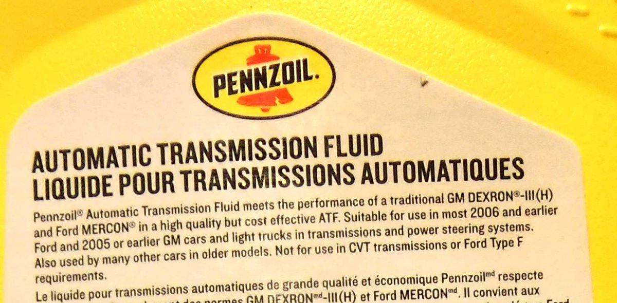

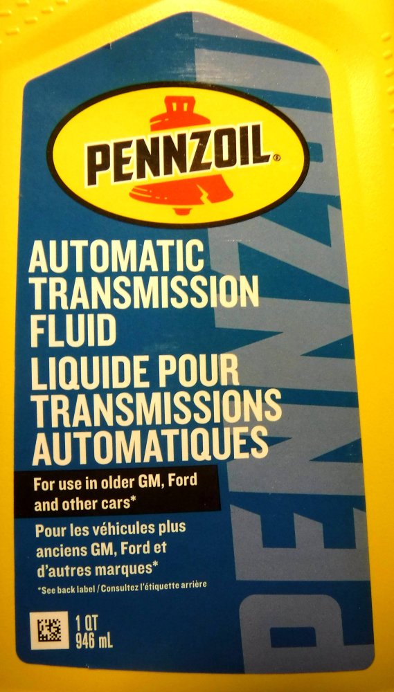

To the OP I found some Pennzoil today at the local "CORN" free station, they also do a fair size oil business, and supply a lot of large farms and ranches around the area.
It's Pennzoil I'll let the labels do the speaking. I went ahead and grabbed enough (@ just over $5 QT) to do my transmission but didn't even think about the transfer case, maybe soon

Mercon V is full synthetic Mercon and is backwards compatible with Mercon, and the old Ford type CJ. When full synthetic Mercon came out it was labeled as such, at some point Ford started labeling it as MerconV. Ford type F and Mercon LV and SP are different.
