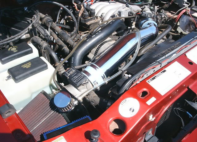

The IAC is the cylindrical looking part on the side of the throttle body. Has one electrical connector attached to it. Simply unplug the connector, the engine should either idle very low, almost stall, or stall. As was said above, it's normal. My 98 Ranger, has been an IAC eater. Lost count of how many I've had to take back to Auto Zone because they kept failing. I finally opted to pay the additional money and get their Hitachi IAC, like back in 2015. Haven't had another problem with it since. Their cheap $39.95 part is made in Mexico. Their premium part is made in Japan Hitachi and costs twice as much. The cheap one's have a one year warranty and rarely make that one year. The Hitachi has a five year warranty, and mine's four years old now.
Picture below, the shiny intake tube. On the right, you see the blue sleeve. Right above that is the IAC. Cylindrical looking contraption with a plug on the end. Maybe the 2.9 is different than the 3.0???

Ok. The IAC is fine. On to the ECT. Is it the two wire sensor just above and behind the thermostat housing?
Yes, its the TWO wire sensor near the thermostat housing, 1 wire sender is near-by but the 2 wire is the one the computer uses
