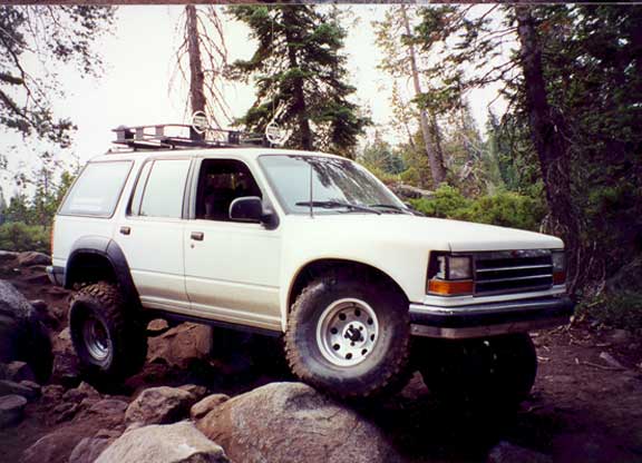

Most I've seen with stock arms/beams.
4" trailmaster lift, claims 13" of travel.
