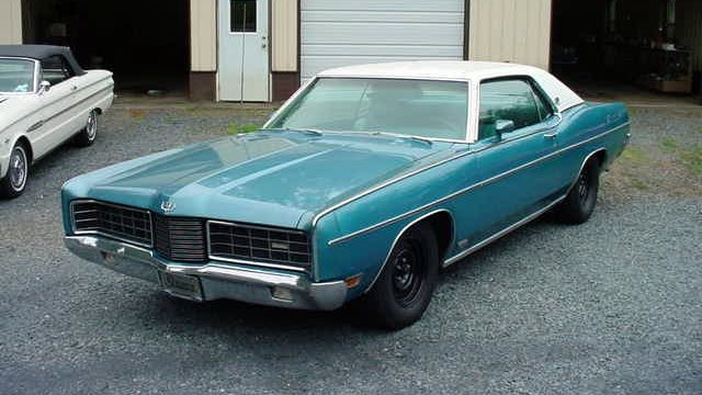

Inline 6 would be very cool too. But you would have to add 4-6" in front of the tire. Then you would look like one of those 70s LTDs with a long nose.

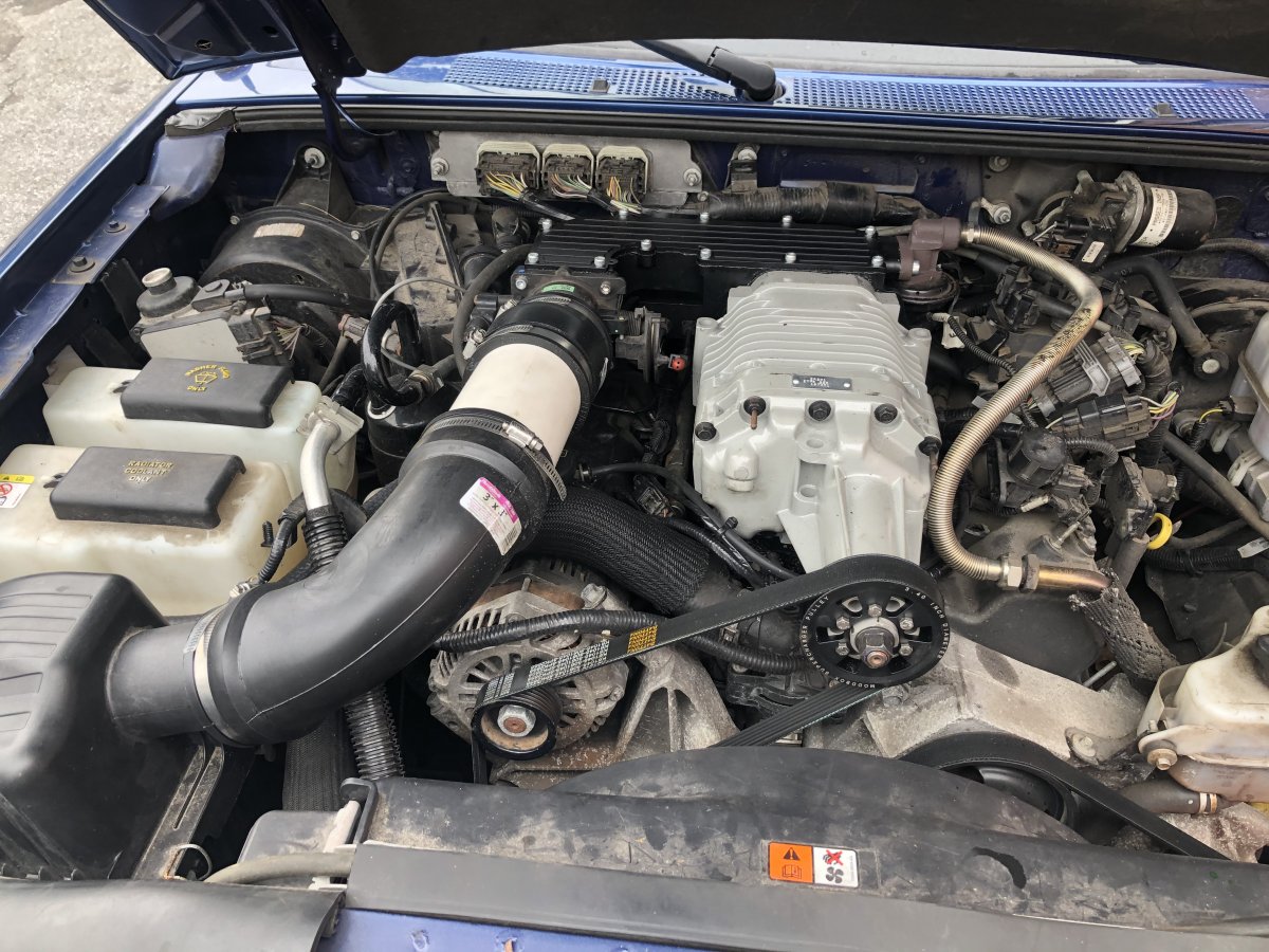

supercharger might be do-able, maybe an M90? probably will be worse on gas than the turbo....at least when cruising at lower speeds where boost is unnecessary. a wieand might be easy, fab up a base plate to match the lower manifold then just throw a sniper on top....and get a cowl hood. but they are pricey, at least it seems like a lot of money to put into a 2.9

I also support the super charger suggestion if you’ve got more then $30 to spend.
