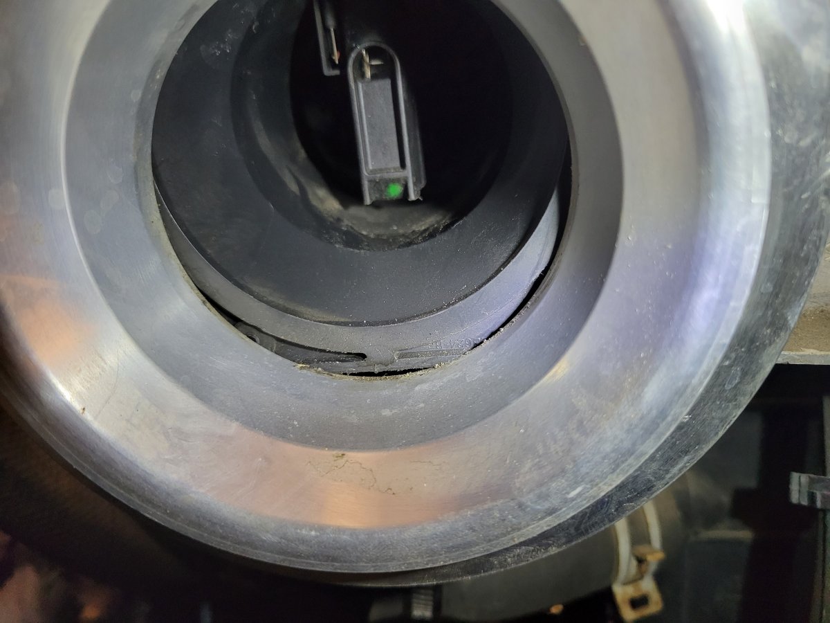

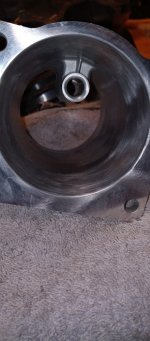

I did m8ne a couple of years ago. 97 model. Aluminum. I took the electronics out of it to keep the dust off the wire. Used a dremel with a flap roll. Used a dewalt oscillator tool to cut the big part out. Then just polished the rest. It helped quite a bit. Id say at least 8-12 hp. Helped throttle response too. I also took the silencer horn off & cut the end of the filter housing larger where it goes thru the fenderwell. And added a $12 ebay find replacement k&n cone filter.
