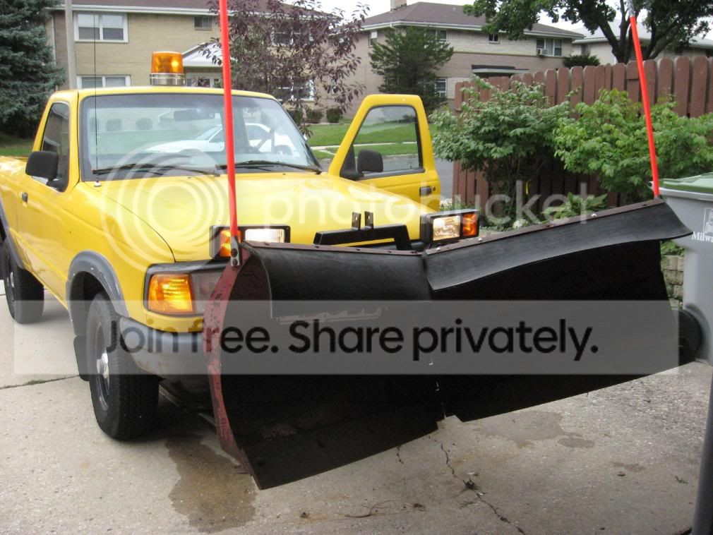

That plow however, I would love to have one.
Awesome plow! If you want to go on the cheap, you can thin down Rustoleum Rusty Metal Primer and slather on a few coats of that. Then slather it on unthinned, takes time to dry, a couple days. If you can't weld,
