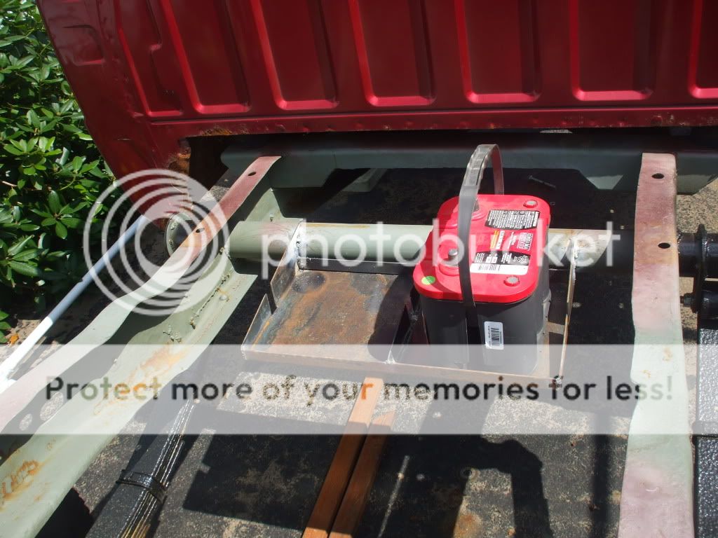

finished up the welds today, cleaned up the rust and hit it with some primer, put some heavy tape between the aluminum and steel to prevent corrosion, I also started mocking up my battery setup.

might want to take a second thought of this crossmember and the battery location. You might be creating an issue at full bump with the driveline, especially if you decide to notch the frame later on...
