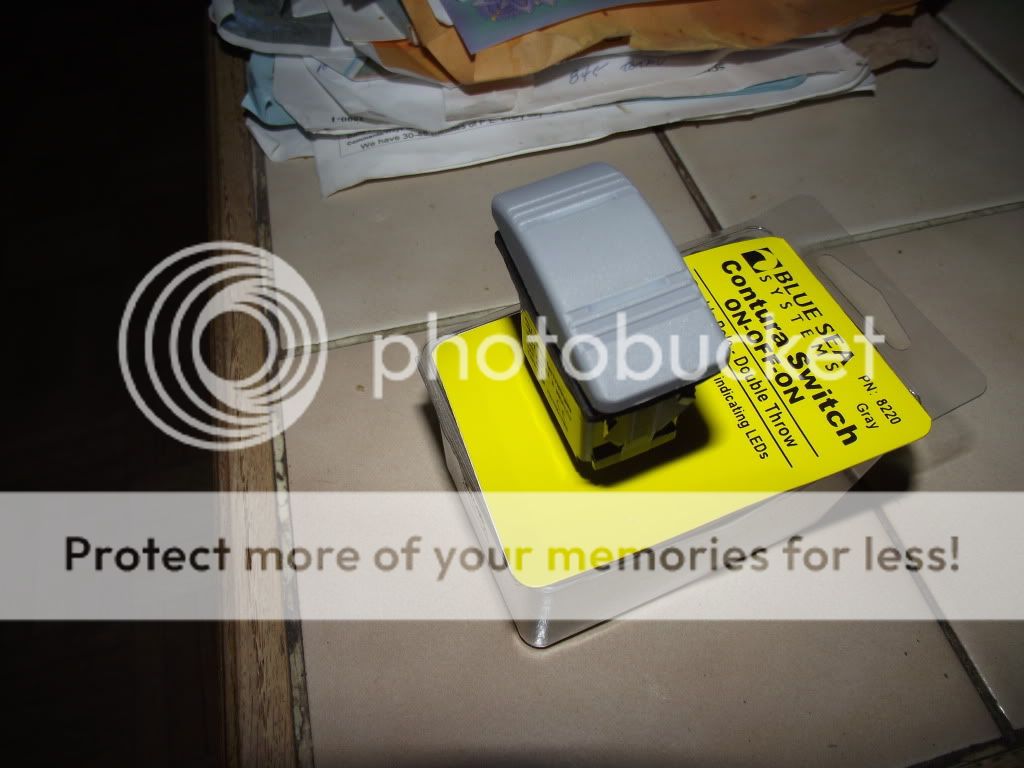

i mentioned earlier i would give you some pointers on wiring that reverse light-here you are.
Mike's '93 4x4
you'll need a switch that's labeled like this;on-off-on.
this one is a marine switch,they are great for trucks because they are weather resistant and use better materials in their construction.

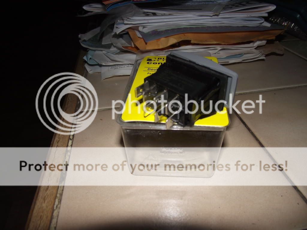

this one is a double pole switch,so it's like two switches in one.that is why there are two rows of three terminals.the one off by itself is the ground for the led's in the face.you will only need to use one set of three,it doesn't matter which set.
the middle terminal will go to your auxillary light.one of the remaining terminals will be for a power lead(for a straight 'on' position)and the other will be tied into the truck's reverse lights(for an 'auto' position).which is used for which is determined by what position the switch will be in for the given operation.the switch in the down position will be connecting the center terminal with the top one,the up position connects the middle to the bottom terminal.the center position is the 'off'.
that's about all there is to it.

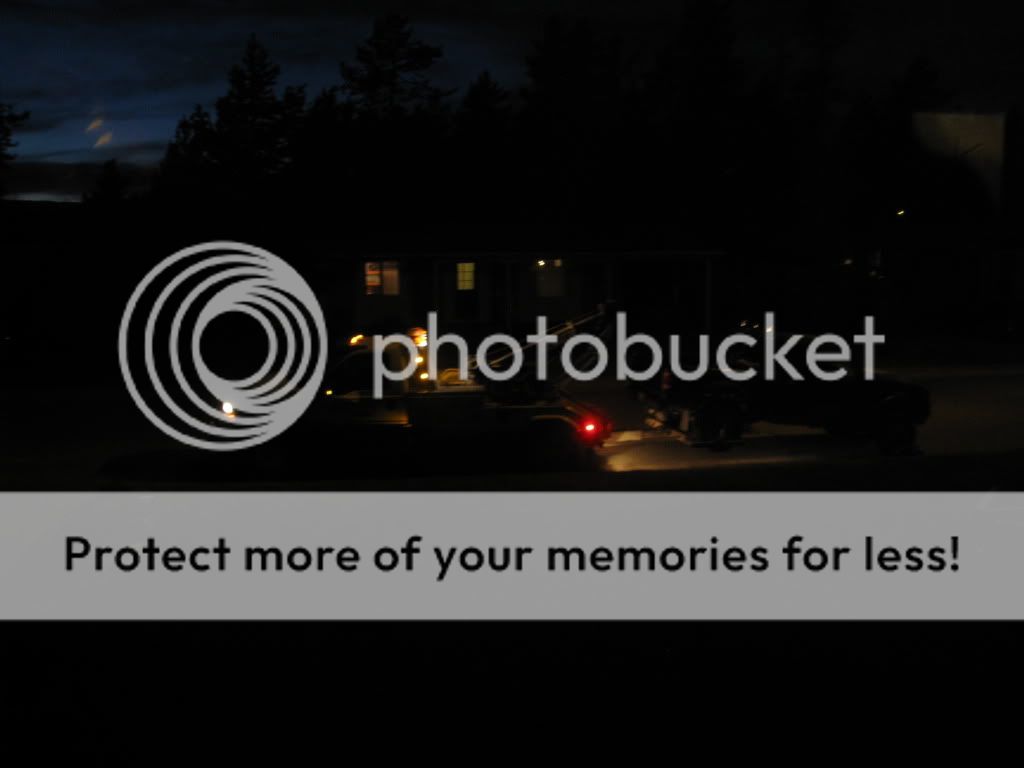

Oh, and RE: The brakes.... this is what happens when you say I'll deal with it later.
Mike's '93 4x4
No fluid in the front and the rears are completely seized, had put it on the hook to get it down to work.
