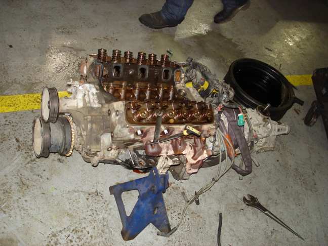

(update, I ripped it out this afternoon and started to tear down. Should have a comprehensive carnage report with pics by tomorrow)

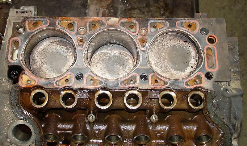

Well, got it all apart, and it is surprisingly unhurt. Cam bearings are marginal and the rings and water pump are toast, but otherwise, no real damage.

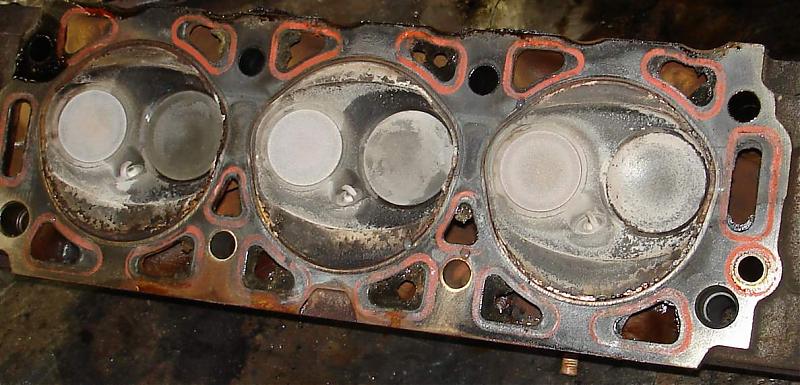

Got the heads off, looked pretty bad at first.
Heads are fried.

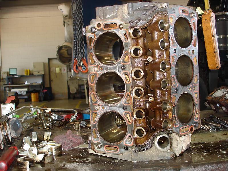

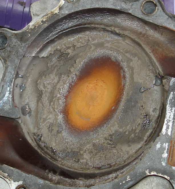

After stripping the block down, I found that it was nearly immaculate. All of the bores look new with only light scratches in #6 hole. So light you can't feel them. Bearings and journals looked nearly new.

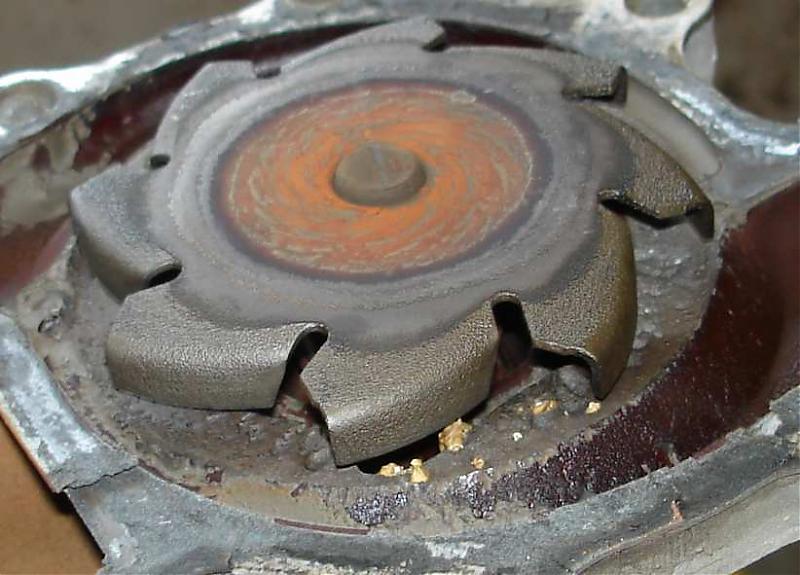

Water pump cavitated pretty badly during overheat.
As did the timing cover to match.
The piston rings are completely worn out and the timing chain has a huge amount of slack. But it appears that's just about all the damage from that water.
Block and heads went off to the machine shop for cleanup and crack check yesterday afternoon. I'll keep you all posted and try to get photos of the build.
