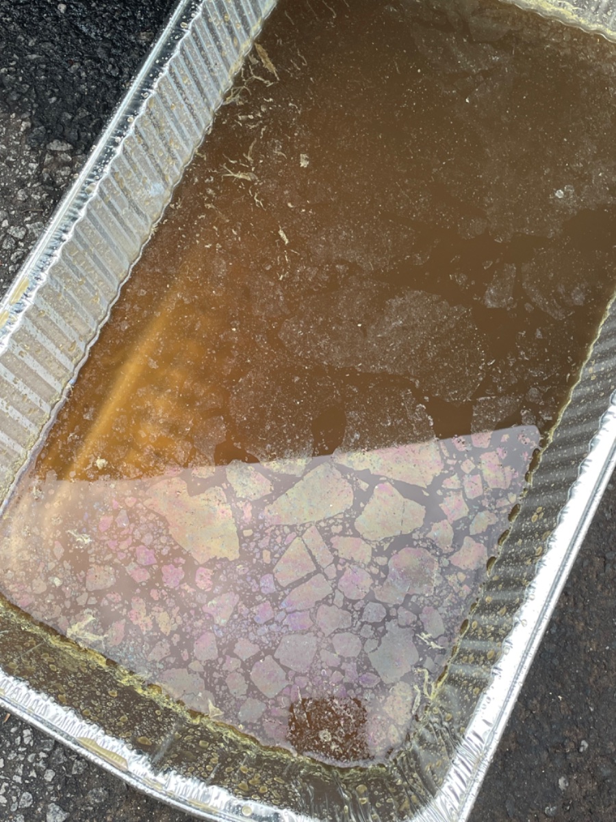

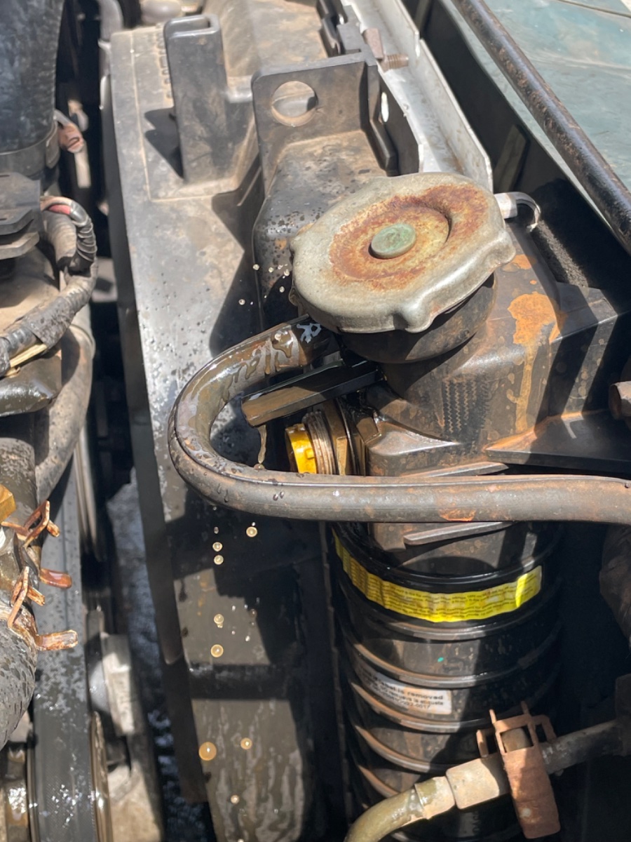

I'm looking at the overheating now, and I started by flushing the coolant from the system. The head gasket has passed several tests by a mechanic recently, but I'm seeing an oily film in the old coolant. Could this be caused by something else? I also had coolant spewing out of the radiator cap after a test drive (definitely not the cap itself, I've tried both the original and a new cap).

I've seen the bottom fitting in the overflow tank plugged or the hose going to the overflow being plugged so I would check that first.
The only times I've had overheating issues on vehicles it's been because of radiators plugged internally or externally.
Did the mechanic test you radiator caps too?
They have to hold pressure.
As far as the film... did you put anything in the radiator that wasn't water or coolant?
