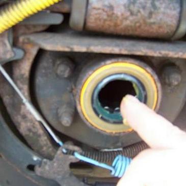

That wet rear end could also be an axle shaft seal.. You'll find out soon enough.
Bleh, I didn't even think about that. But never seen that happen before either. Borrowed a jack from work, and after I refill it and hopefully get it working again and take it apart, I'll find out. I haven't been noticing the brake fluid reservoir emptying... so maybe.
It's not a terrible job to change the axle shaft bearing and seal. Plus it gives you an excuse to learn more about your truck and change the (possibly very) old differential fluid.

I’d pull the axle shafts first and inspect the area the bearing rides on, look at what you can see on the bearing. Just because a seal is bad doesnt mean the bearing is too. And of course there’s always a chance that not only is a bearing bad but the axle shaft might need replaced if where the bearing rides has damage.
Pulled the tire and drum. Wheel cylinder leak, not axle. Also my parking brake cable is broken in the drum. Removed everything, cleaned, tomorrow I'll reassemble with the new cylinder. Semi-long term I would like a disc brake conversion, I hate drums :ROFLMAO:
