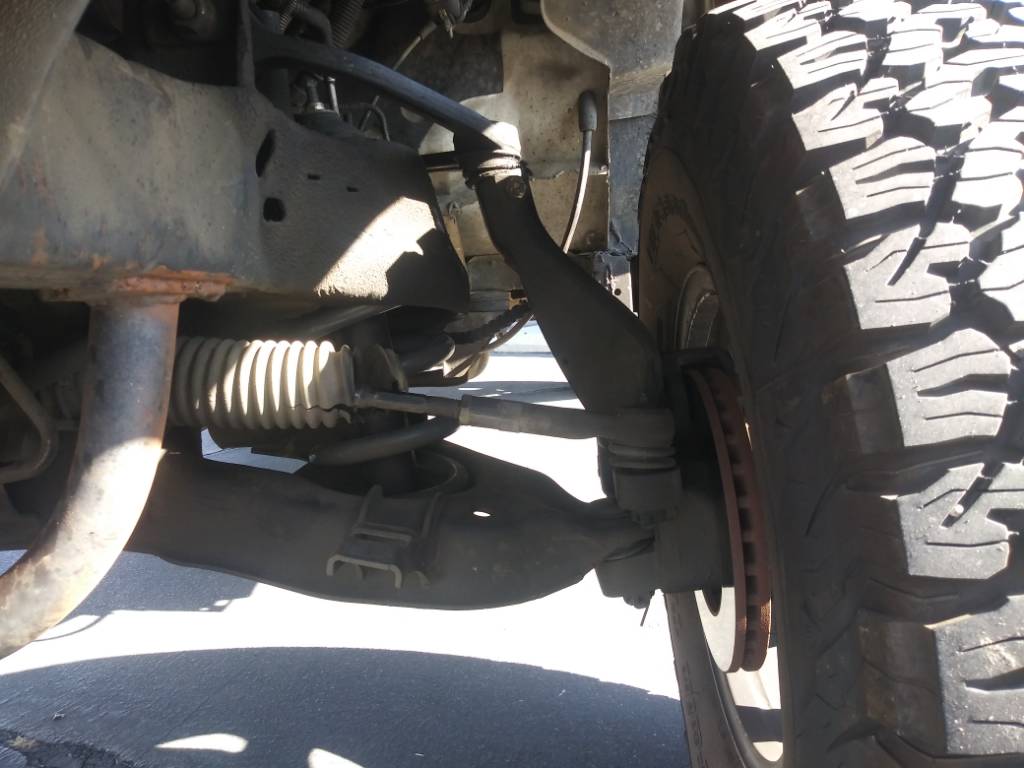

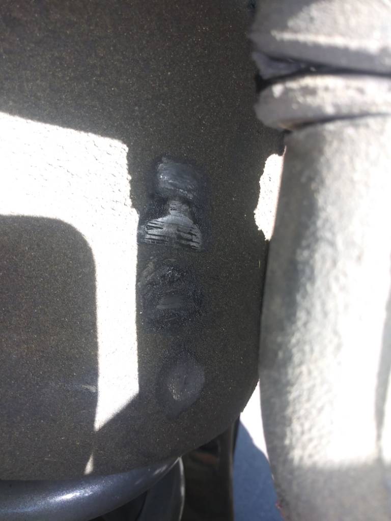

So I have these don't get them
Spindles will grind your coilbucket when extending
Also this is pulling everything and my entire front ends joints need to be replaced
Sent from my LM-X410(FG) using Tapatalk

Alright here's what you need to know . don't buy there kits . I got the 99 lift kit with spindles coils shocks and shackles . rear has no problem. the spindles hit my coilbucket and it's destroyed my front end and I am needing to replace my uca tie rod ends and ball joints from the contact . from what I'm told the rangers suspention is limited by the shock leingth and the max Trac shock is to long therefore the spindle when at full droop smashes the coil bucket
The coils will only lift the set point of your front end and not give any clearance upgrade I am going to switch to bilstine shocks on my front end (they are an inch shorter) and see if I get the bumping if I do I will have to get limiting straps
Update to this the company is basicly telling me to go **** myself so here's my experience
