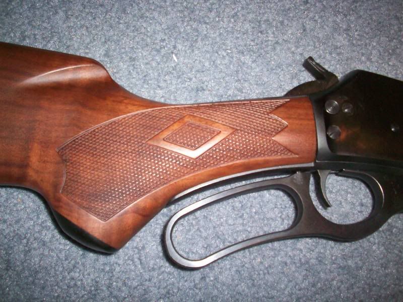

Got me a package today:
Marlin 336C debicle
They changed the stock because of fitment and the barrel because of headspace issues.
The stock is lovely with the checkering cut so deep the diamonds don't really have any tops left on them. It doesn't fit the receiver any better than the original stock either.

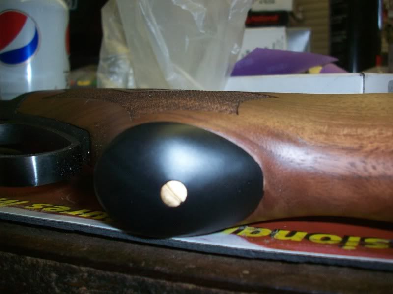

The grip plate is loose, awesome QC. :icon_thumby:

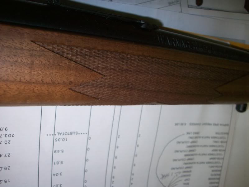

They didn't change the forearm, it still has the same crappy checkering it did before and still doesn't match the stock in color.

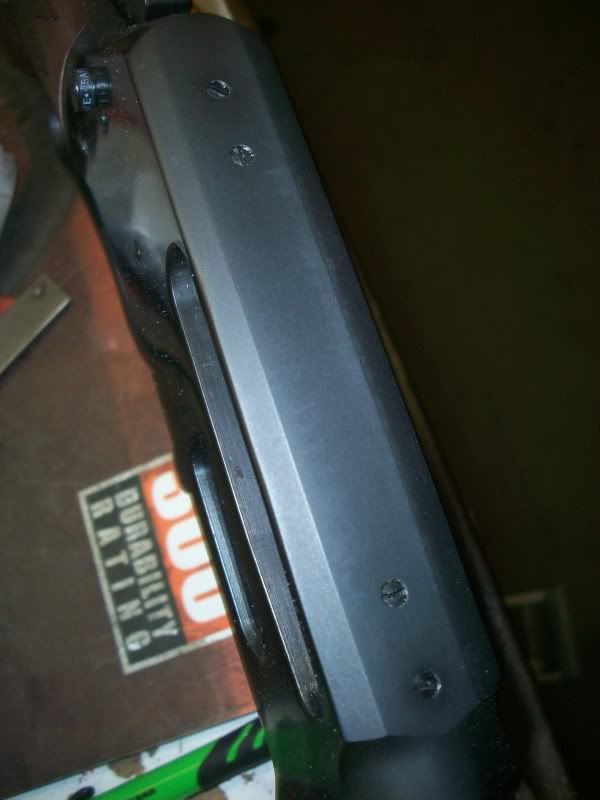

Moving on to the receiver the bluing on the top of the reciever is all scuffed up.

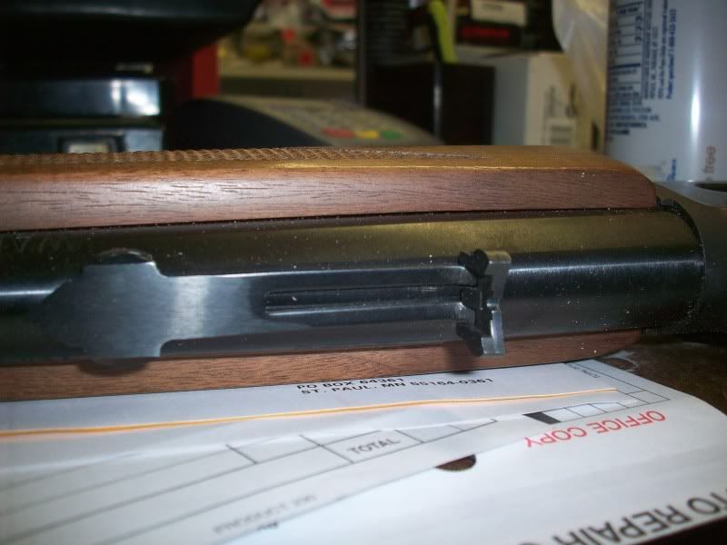

First question of the day is how I am supposed to adjust elevation without a ramp in the rear sight. Also note the bluing worn away from the sight working against the brand new barrel. If you notice the angle of the sight vs the forearm that is another problem too.

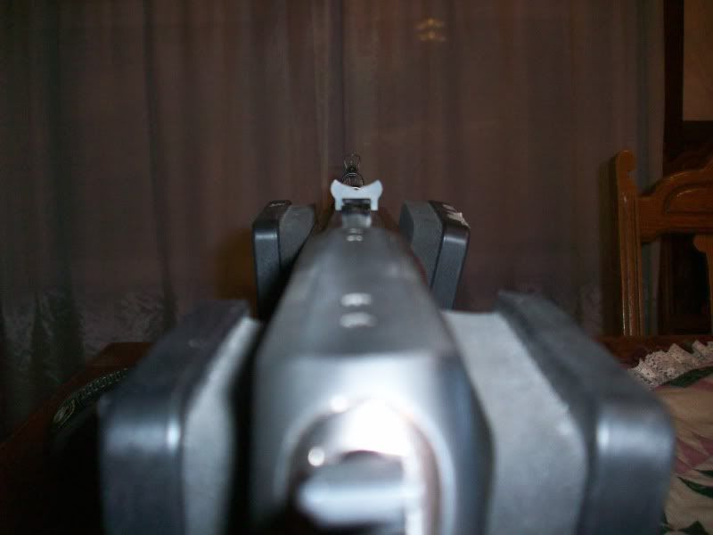

Second question of the day is how I am supposed hit anything with the sight mounted on the barrel crooked. I would have gotten a peep sight anyway but it would still bug the heck out of me and detracts from the value of the gun. It would take a lot of the adjustment to get it to center... on a new gun with a straight barrel I would think it should be close to center provided the sight is straight. There is about 1/16" of slop in the rear sight, even clear to the one side it isn't close to lining up. It is pretty much centered in its dovetail too.

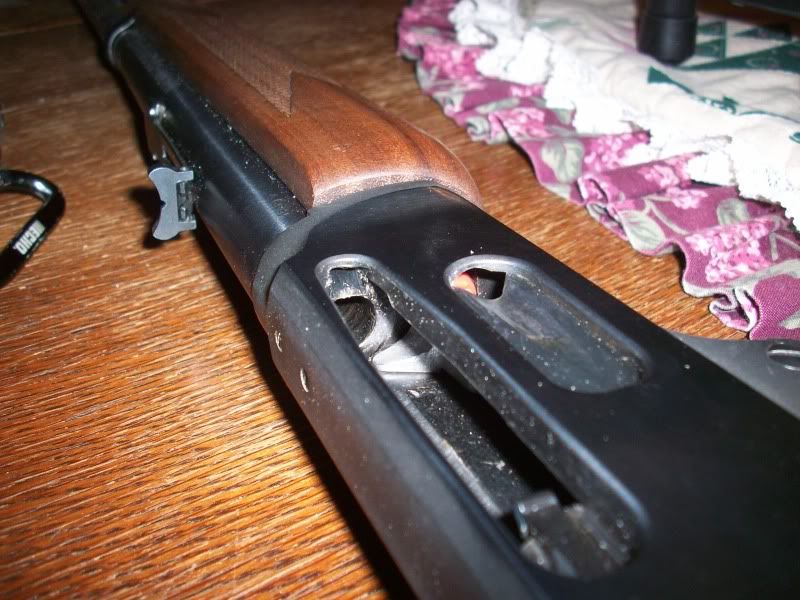

Now it ejects with authority, I love it. It still doesn't feed for crap unless you REALLY get after it. Like the opening scene of Rifleman after it, I don't think the gun won't last long banging it that hard. Also of note is the steel filings they left in the gun. This is at TDC for the elevator, in dad's older model 95 45-70 Cowboy and 94 .45LC Cowboy Marlins (both based on the 336) it comes really close to being even with the chamber. My theory is when you lever it hard it flings the shell up (lightweight aluminum snap cap) the bolt catches it midair and throws it into the chamber.

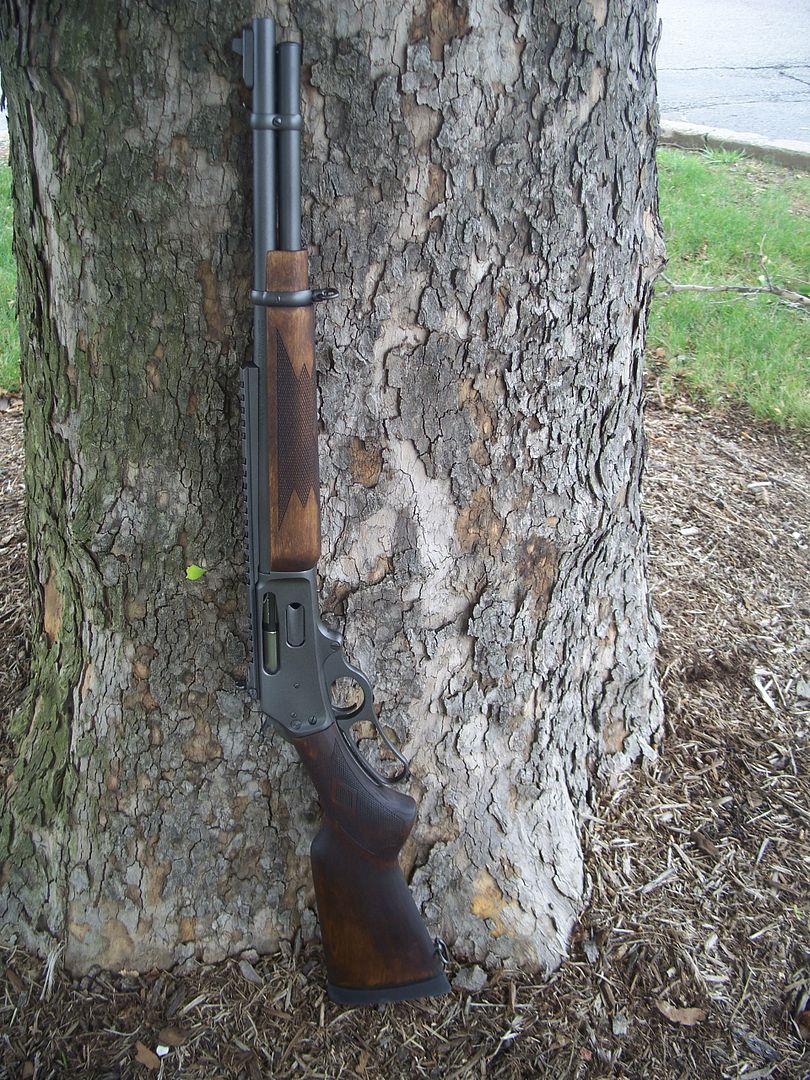

This one is damn sexy.

That custom gun is a neat spin though. :icon_thumby:
