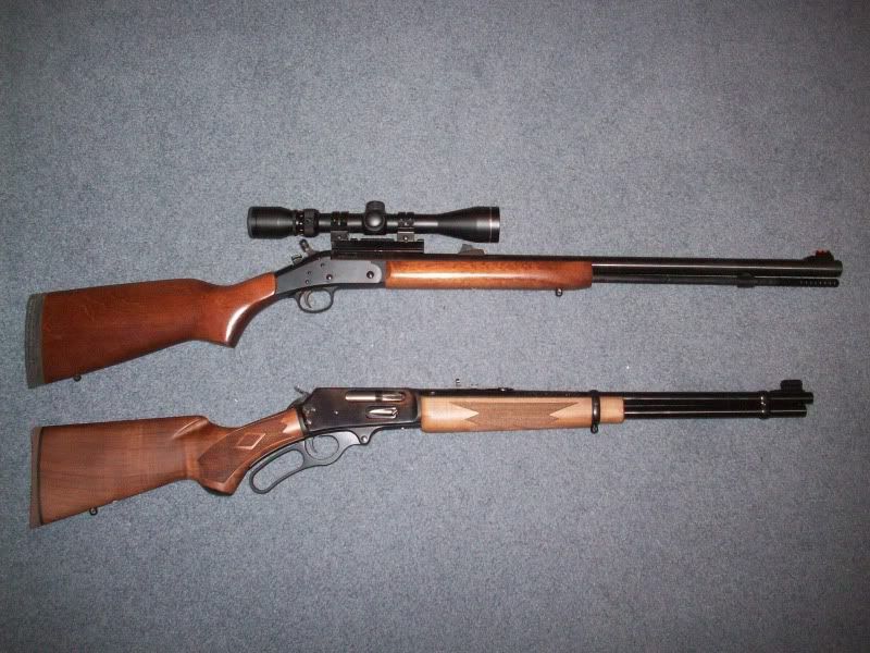

Last May I bought me a brand new Marlin 336C 30-30 lever action. Walnut stock, nicer sights, factory sling mounts... pretty nicely appointed gun.
Shown with its bloodbrother, H&R Sidekick .50cal muzzleloader.
The action was rough at the store, I blew it off as a new gun being stiff. I noticed the stock didn't match the forearm and thought it would add charactor and bought it (obviously at this point) It is has glare on it in the above picture, it isn't THAT much of a difference.

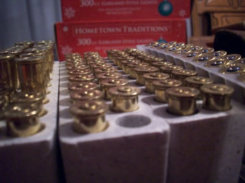

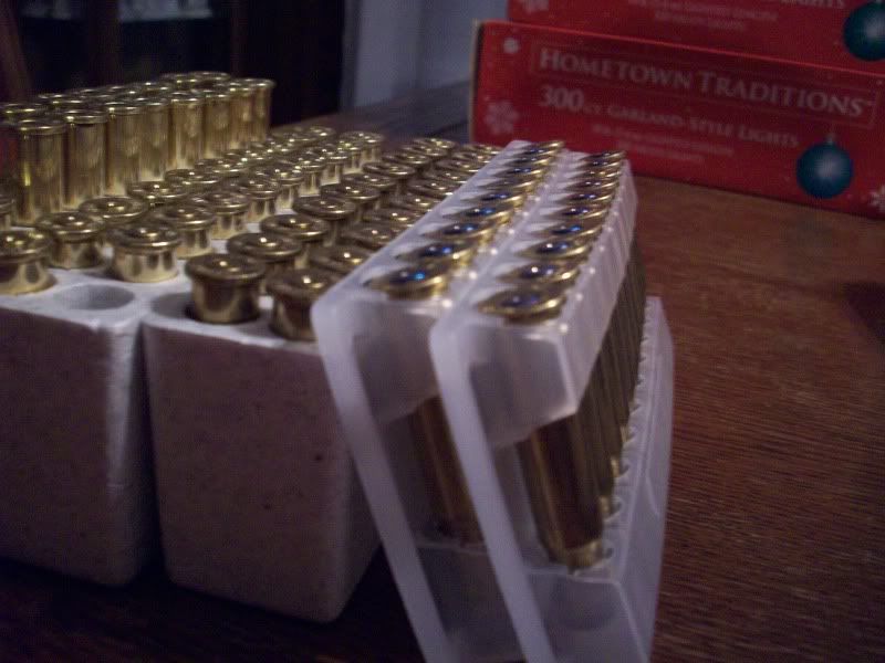

Third time out last weekend the cycling fun it got worse... I also noticed something funny with the primers on the empties. Dug out my old empties and it has been doing it pretty reliable the whole time.
So then I did an internet search for popped primers and it is either from too hot of a load or headspace out of whack. I am shooting factory ammo (Winchester in the foam blocks and Federal with the pretty blue sealer around the primer) so I don't think I can pin this on the ammo
