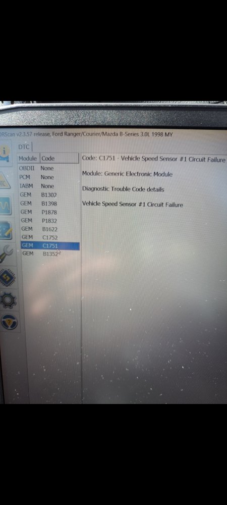

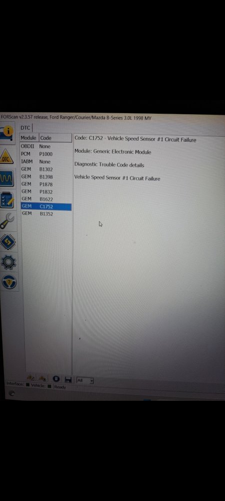

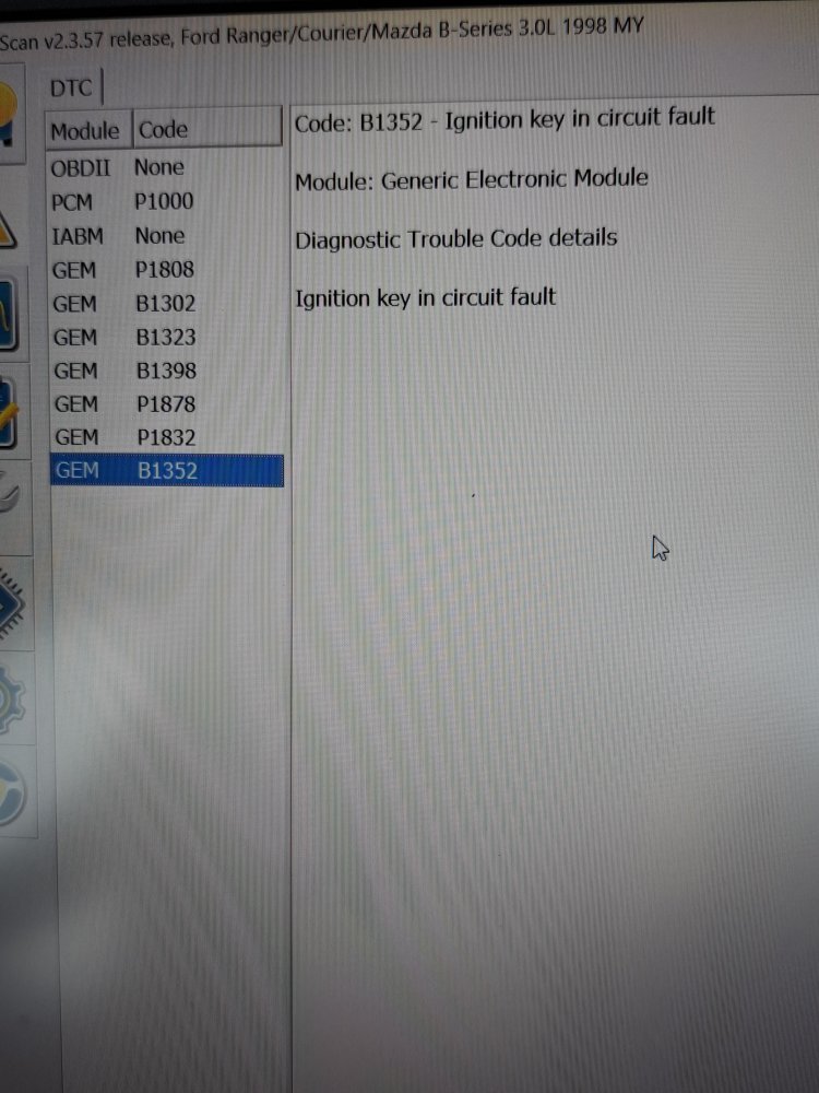

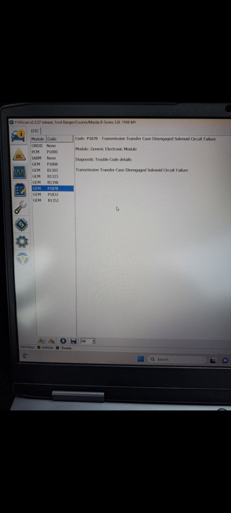

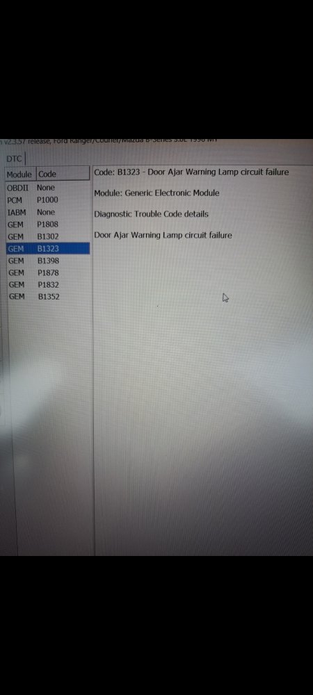

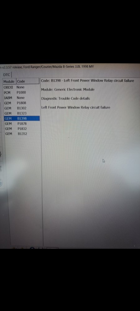

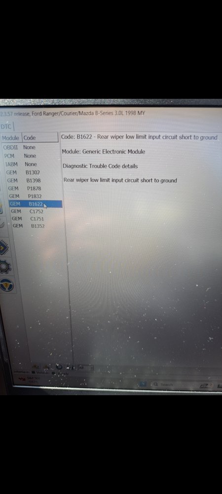

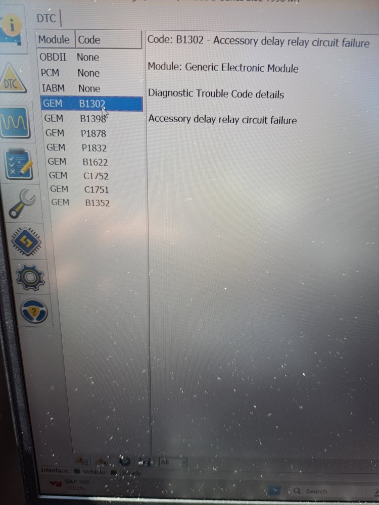

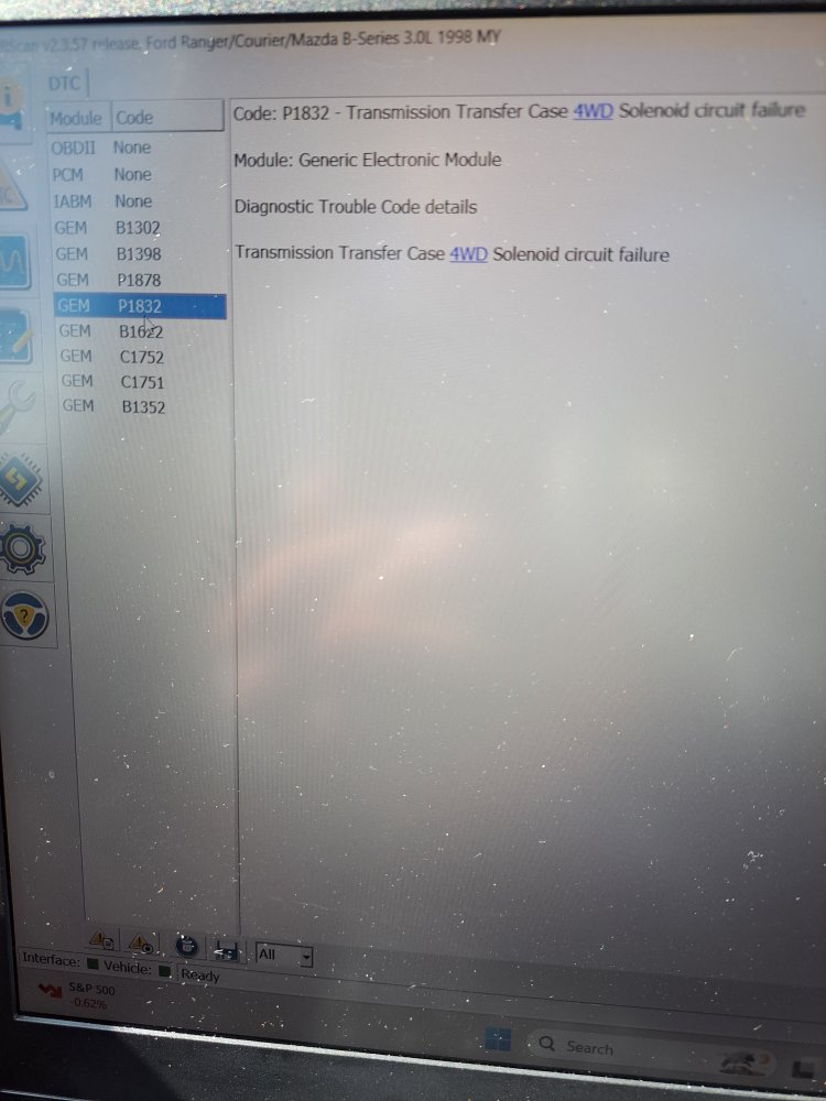

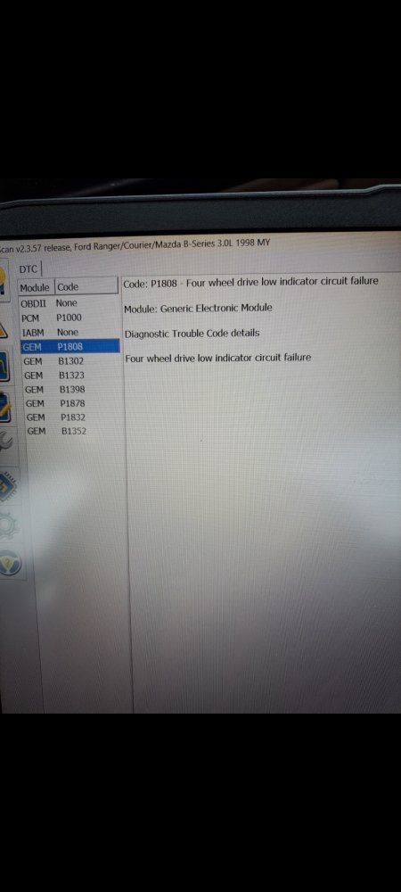

Missed shifts, delayed shifts, doesn't down shift into first coming to stops most the time while the rpms hang at 2k making it very hard to stop givin it won't shift, doesn't like overdrive and 50 is what she tops out at unless I floor it, 4x4 low issues, lights and switch all work, door ajar light and dome light stay on too long, wipers cut out. The truck is manual everything no power windows. If I'm in drive stopped and hit the gas then let off quickly the rpms will go up and get stuck pushing the truck forward till I either put it in neutrual to stop it, on wet ground it peels out. I was sideways at an intersection. One shop told me iac so they replaced it to no avail. Another told me transmission and the last one told me torque converter while they all are disregarding the gem codes stored for many months cleared and stored again. I also replaced rear abs sensor, cranks sensor, cleaned maf, cleaned throttle plate, cleaned connectors and battery. I pulled the gem and it has 2009 stamped on it so it's been replaced before. Cleaned every connector behind the radio including 4x4 relay checked fuses and relays all seem good. I've been to three shops that never looked at it more than an hour and I'm out hundreds of dollars. Any help would be appreciated. Engine light has never come on, just hidden gem codes. Is the gem bad again?

No probably not the GEM or you wouldn't get codes, but could be
Your Drivers door switch is most likely bad which is why the dome and door ajar stays on with door closed
Ignition key ground wire may have been cut or otherwise disable to stop the Chime

Maybe previous owner swapped GEM out before, i.e. odd power window code

The speedometer has been fine mostly but on a handful of occasions in the last few weeks it's lost total calibration for about 5-10 seconds and starts jumping all around as I'm going down the road till is finds itself and dials back in to correct speed. The 33's cause the speedometer to show about 7 miles slower than what I'm going at highway speeds. There is no door chime when I have them open so maybe it's been cut. I'll check it out as well as the door switch. I've disconnected and reset the computer more than a dozen times due to disconnecting things and reconnecting things. I can't do it with forscan due to an error but I had the battery unhooked all night and day yesterday. I always leave it unhooked for near an hour and it always resets because I can hear it when I turn the ignition. I've had it 5 months the previous owner was my cousin a manager for big 0 he only owned if for 5k miles the original owner from day one was an older guy who put 150k on it. Yes the gem was swapped, it has 2009 right on the sticker of the gem casing. I find it odd I'm getting power window, rear wiper, accessory relay delay, all circuit failure codes and its a manual in every way as far as roll up windows and no rear wiper. As far as the speed sensor codes go could that be in correlation with the shifting issues? If the pcm isn't getting input from the gem? It acts like my f150's and expy did when the rear abs sensors failed.

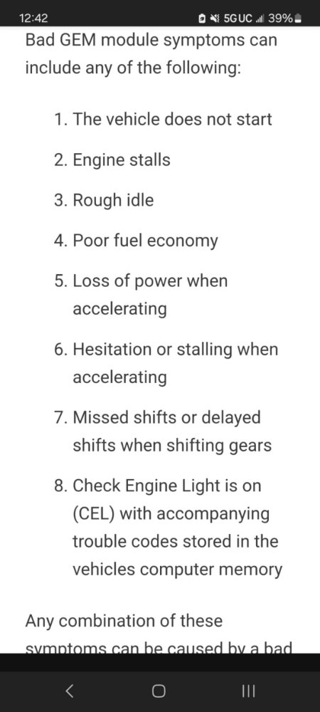

This is what made me think the gem could be the culprit. The truck showed a p0320-p code a month ago and for three months hear and there it cranks strong for about 5-7 seconds then it sounds like it sucks air chugs for a second and smooths out. It doesn't happen often and it's much more likely to happen after a steep hill and letting it sit for a while after. I replaced the crank shaft position sensor and has only done it once for a couple seconds since then with no code return. The no start and rough idle at first made me think gem with what this sceen shot shows. Before the iac was replaced I replaced the pigtail connector and wired it myself with weather proof heat shrink connectors.

That is totally bogus info in that screen shot
Only GEMs that can work in a 1998 Ranger are from a 1998-2000 Ranger or B-series

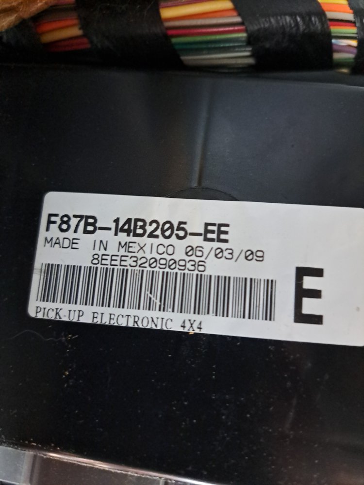

Perfect thank you for clearing that up for me. I'll dump that screen shot and theory. This screen shot is the gem that is currently in it. It shows f87 on it but also, I believe it was just remanufactured in 2009 so it is probably the right gem. If it's not the gem that's bad most likely what else would you suggest I look at for the shifting issues and codes such as speed sensor in the gem

That is a valid part number for 1998 Ranger 4x4 GEM
Here are the ones listed
ID F87B-14B205-EA
ID F87B-14B205-EB
ID F87B-14B205-EC
ID F87B-14B205-ED
ID F87B-14B205-EE
Thanks! Then I can rule out the gem as an issue and start looking other places for the code faults. I read the date and first thought it was for a 2009 model year, but it was just made/reman back in 2009. Good to know.
