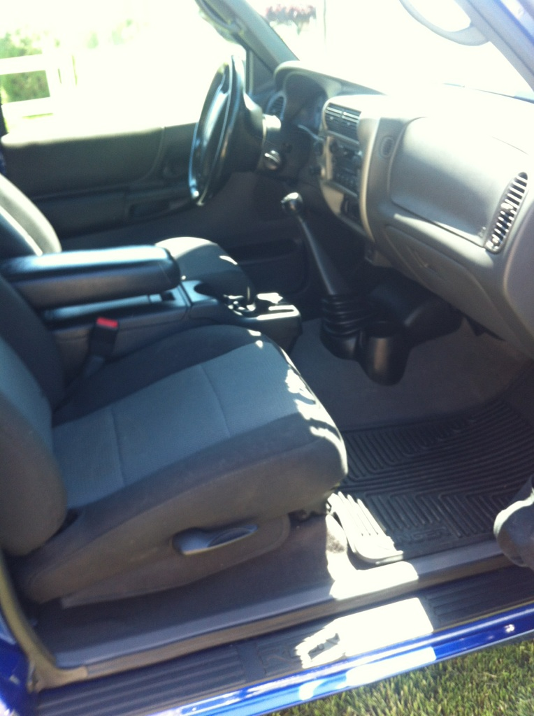

going to bump this thread, some of you will recognize this truck from my FRF days. It was a 2003 FX4, Sonic Blue, 4.0, 5 speed
