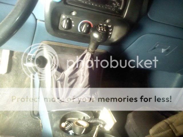

I cut the threaded prortion off off the stock shifter and welded it to a peice of 1/2" rod that I put 90* in.

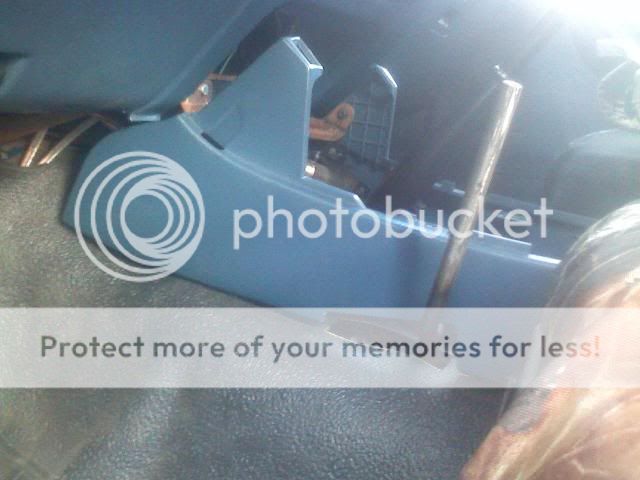

I Had to trim the console out a good bit

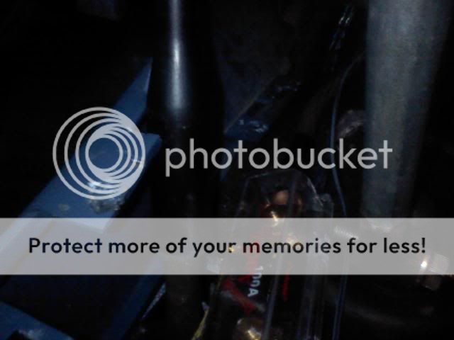

The lever is almost touching flloor in 2 hi, but 4 lo it is 1" away.
I made it hug the console to keep it away from leg.
I spoke to soon when I said I cut the hole perfect on my first try. It turns out I didnt make it wide enough, so when I had everything back together and went for a test drive, I found out that when I give it a little gas the transmission torques a little and the lever rubbed the edge of the hole making a terrible scratching/popping noise. So I had to take everything apart again to trim it up a little bit.:annoyed:
I am still playing around with different boot ideas, I am using a piece of rubber that I cut slits in, but it doesnt flop down arounf the lever very well. I am looking for some sort of brush or boot from a car with a hand operated e-brake.
