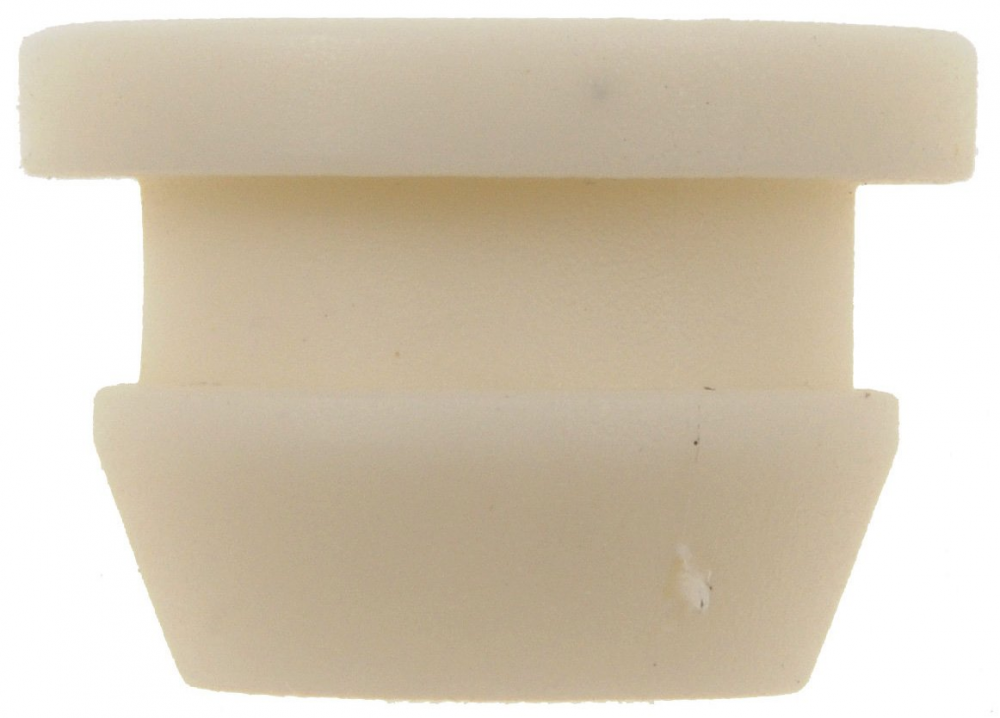

You aren't talking about something like this, are you?
30537
3L5Z-7335-AA
It's not exactly the same, it's for a newer Ranger but it should work.
3L5Z-7335-AA
Yes, that looks very similar! The one I have is a full circle.

The original full circle one was discontinued years ago. This one is used on newer Rangers, but it will work fine in place of the older one.

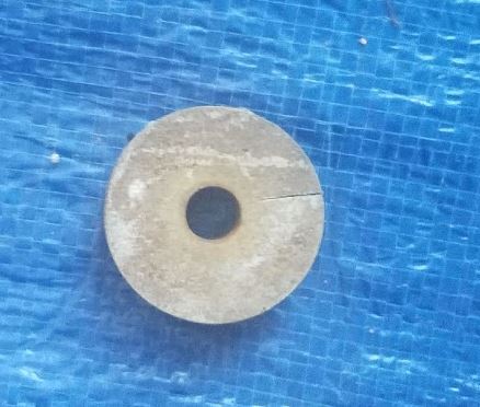

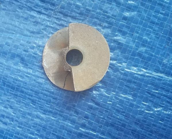

I snapped a pic of mine tonight.
It is actually not bad. I might just glue some washers to the side of it and reuse it.
That's fine... put it back in and use it like that.

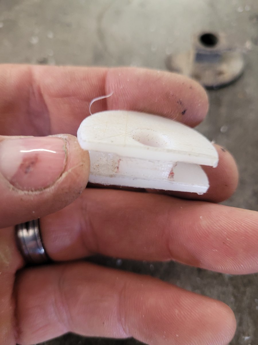

I was going to make something, or try to repair mine if I couldn't find one!
I made a few in my shop. You can DM me if you need one.
