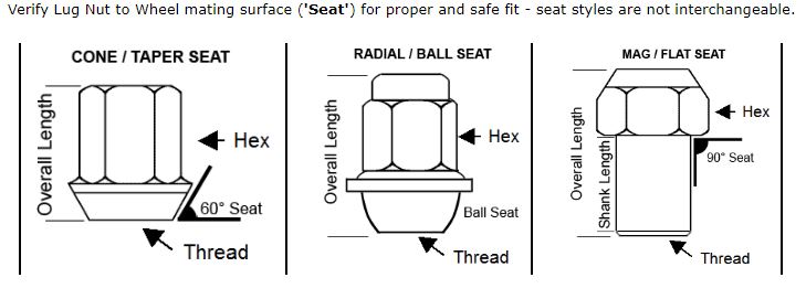

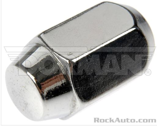

OEM wheels? If not, does the center bore fit properly on the hub? Are you using the proper lug nuts? Conical for a wheel with conical seats and flat for a flat seat?

Going with the majority here, with wrong style nuts
Another issue I've only seen once, but is possible.
With this style lug nut, the stud bottoms out in the nut and you end up torqueing the nut to the stud, not the wheel.

I'm going with this as well. Tomorrow I'll hit up the parts store and get a new set of proper lugnuts.
