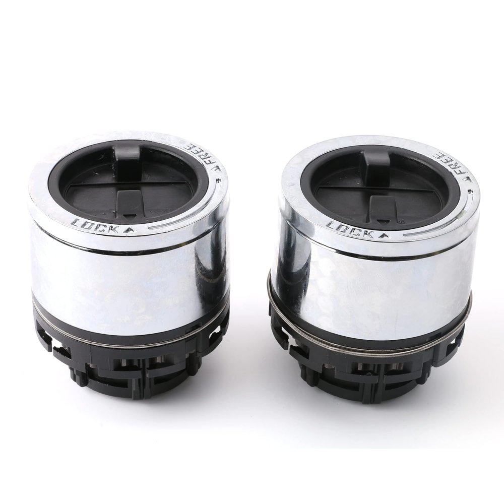

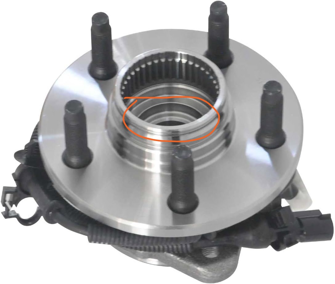

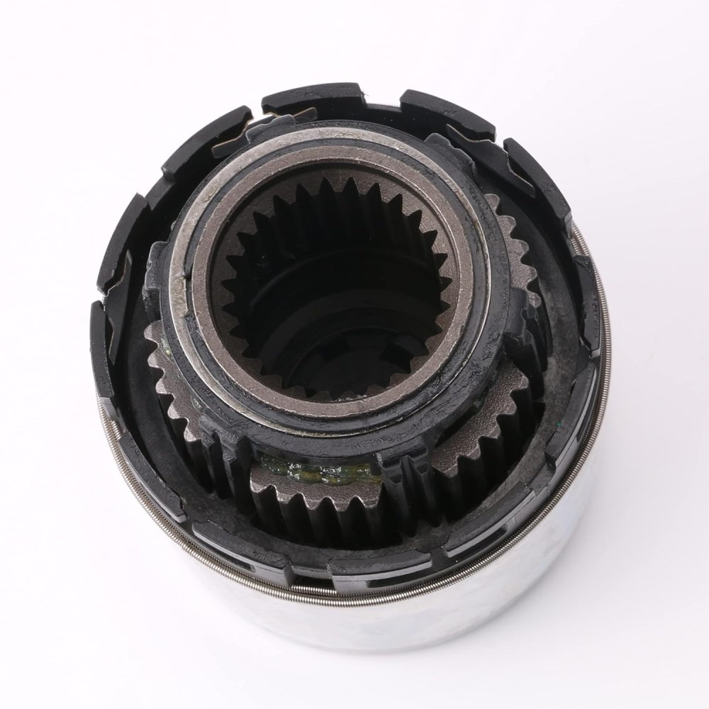

Here are some pics to help. I am referring to the 4x4 locking hubs; not the wheel bearing/hub assembly. The 4x4 hubs attach to a lip on the wheel bearing/hub assembly. You can see how they just clip on. You can pop them off with a screwdriver.
Now, normally, the CV stub rotates smoothly in a circle with the assistance of the hub assembly and 4x4 hub holding it somewhat in place. Once the 4x4 hubs are engaged, they are either driving or dragging on the CV stub. If there is enough wear in the CV axle on the stub, it will try to move in an elliptical pattern instead of circular. Since the 4x4 hubs are only held on by the plastic clips, there can be enough pressure from the stub portion moving in the elliptical pattern to pop it off. Since the 4x4 hub internals are plastic and metal, this usually causes them to break into two parts.
