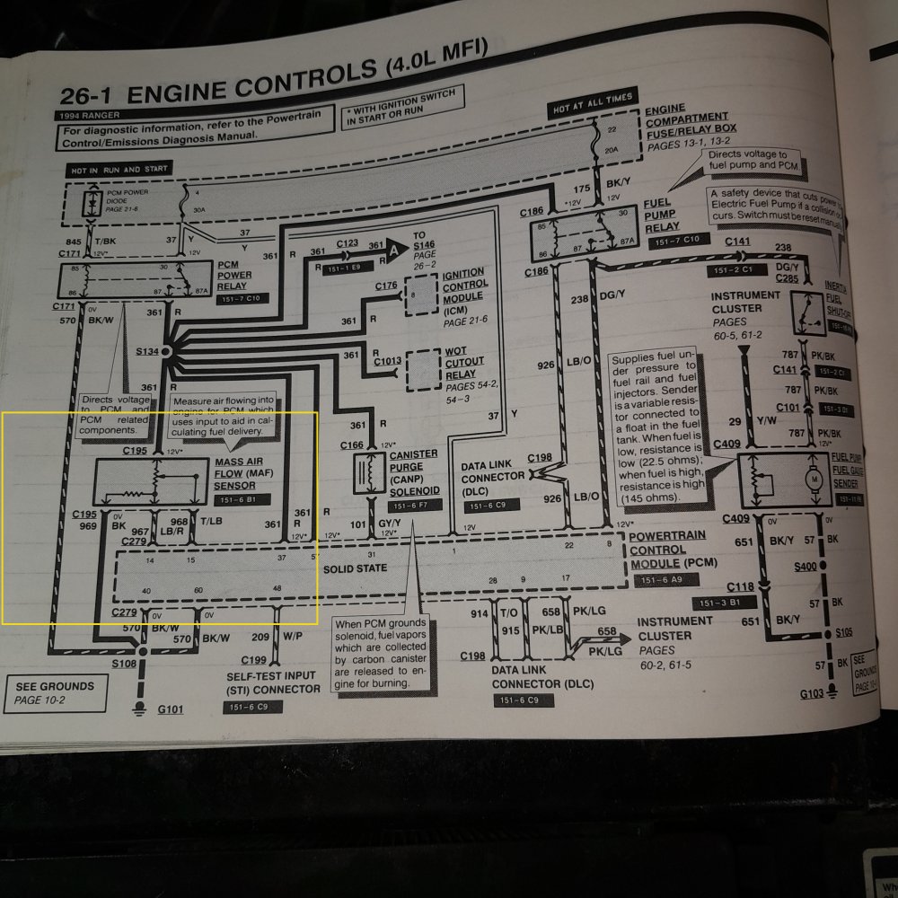

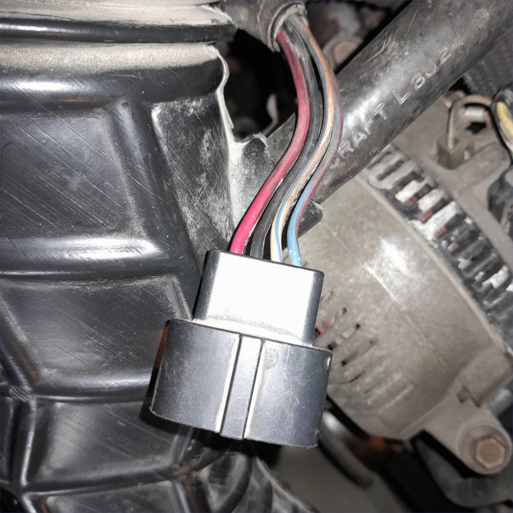

I've been having MAF issues lately and could use a little push.
It started a week or so ago. It would start and immediately stall. Code was 157, low voltage, mass airflow sensor. I removed it, cleaned it with MAF spray. Checked the air filter and hoses to ensure there were no obvious leaks or blockages. Swapped out a couple of other sensors I had from the Pull-a-Part with some varying success. Finally just bought a new one. It still stalls immediately after start-up. If I disconnect the MAF, It runs rough, but runs and is driveable.

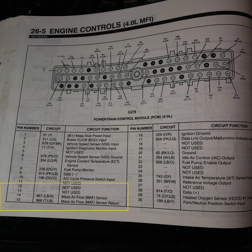

How do I check the voltage? I think one lead goes to ground and the other to one of the four pins. But what should the voltage be? And is there anything else I should be looking at?
Thanks
