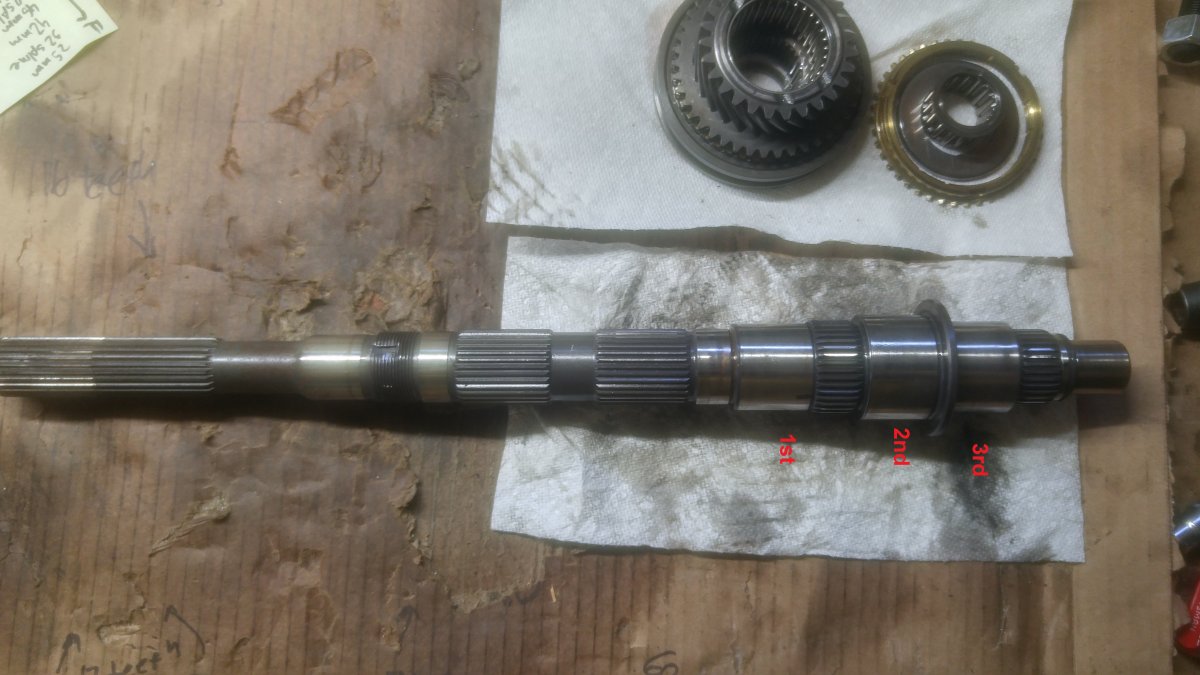

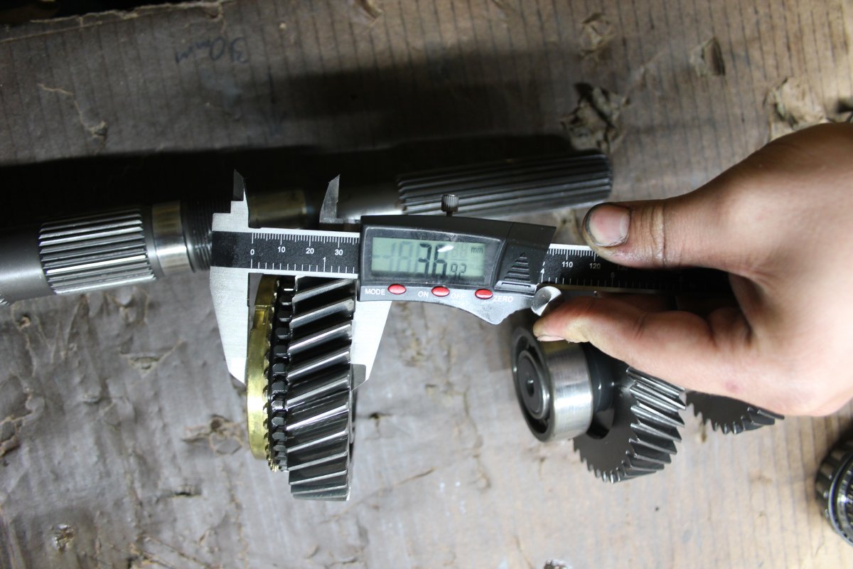

The teeth counts provided are for the individual gears on the main shaft. I figured someone could accidentally swap them around pretty easy.
I did not count the overdrive gears, unfortunately. They should be the same. I will update that eventually...
Here is the full table for what I did count:
Gear4.0 Main4.0 CounterOther MainOther Counter
135173616
231253224
327342932
