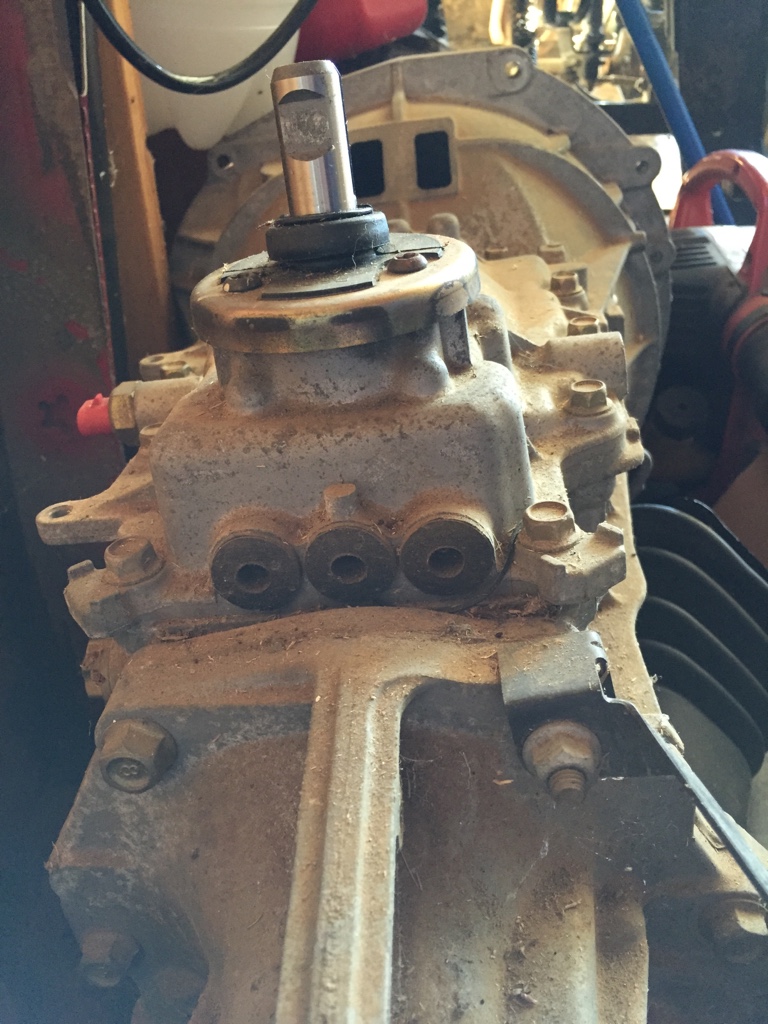

I recently drained and re-filled the Trans fluid in my 91 ranger. Now I smell Trans fluid in the cab. I did this service 2-3 weeks ago. I noticed a small drip coming off the bottom of the case. I've heard the 3 rubber freeze plugs go bad, especially after a drain/fill. I also heard you can access these plugs on top of the transmission from inside the cab. Does the seat really need to come out to access the inspection plate? Or can I just take the shifter boots off? Thanks in advance.
I think you can access the plate without removing the seat if it's an extended cab...might be a bit tight with a standard cab...unless you want to hack the carpet...I was just sitting in a 91 ext cab yesterday and it didn't have any carpeting...I could see the entire access plate and could have removed it if I wanted to do so...
But replacing those three seals requires removing the plate...and I'm going by memory of the last time (2004) I had the plate off...I have my boot off right now and I can't see the plugs on my 88/96...
So I guess it depends on cab style...
Thanks for the reply Mark. My truck is a standard cab and it has the rubber flooring.
I'm not really sure what I'm looking for. I had the shifter boots off when I filled the Trans up with fresh fluid. I ran a hose down through the bottom of the cab at the shifter boots. I don't recall seeing any holes in the top of the Trans case. Wasn't really looking for them either. Can anyone chime in as to carpet /flooring removal? Does anyone have a pic of the freeze plugs? Thanks.
I was just out and pulled up my boot and bottom boot...the plugs (not freeze plugs btw) are not visible without removing the access plate.
Did you over fill the transmission by any chance? The top plug on the M5OD is the fill level and if, as some do, you fill it through the top plugs you can over fill if you don't remove the fill plug and watch to see when it starts coming out.
Overfilling the transmission will result in having the fluid smell inside the cab...as would not properly sealing the floor...which should be well sealed to prevent Carbon monoxide from entering the cab.
It may be over filled. Thanks for the clarification for the name of the plugs. Thought it was strange when I read on another thread they were called the "freeze plugs".. I watched the fluid pour out of the fill hole before I closed it. I've always closed the fill hole as it starts to pour out, rather than wait for a trickle. I thought about checking the fluid level this way, but figured I would just jump into the worst case scenario [emoji23]. The floor is definitely not sealed properly. Sounds like my transmission is in the cab most days. The guy I got this truck from didn't take very good care of it. The floor is also pretty rusty with holes. It's been raining its butt off here the past few days and I haven't even driventhe truck, but the yellow cushion under the rubber floor is wet. Any ideas?

Ranger1997, thanks a lot for the Trans pic.
