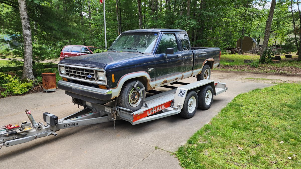

My 13 year old son and I are rebuilding an 88 Ranger XLT for his first vehicle. We have two trucks available to us.
Truck 1: 88 XLT 2wd with a 2.9l and M50D-R1 transmission. This truck was his great grandma's, she's owned it since brand new and it has about 80k miles on it. The motor and trans are clean, run well/ shift well but the truck was a Michigan truck so the body and frame are destroyed from all those years of salted roads.

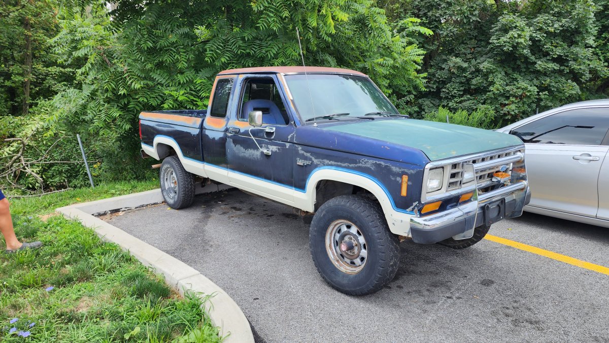

Truck 2: 88 XLT 4wd with a 2.9l and AL4D auto transmission. This truck is a super clean Arizona truck with near prefect body work and frame. But the motor is leaky and has years of caked on grease. It's also automatic and we both really want manual transmission.

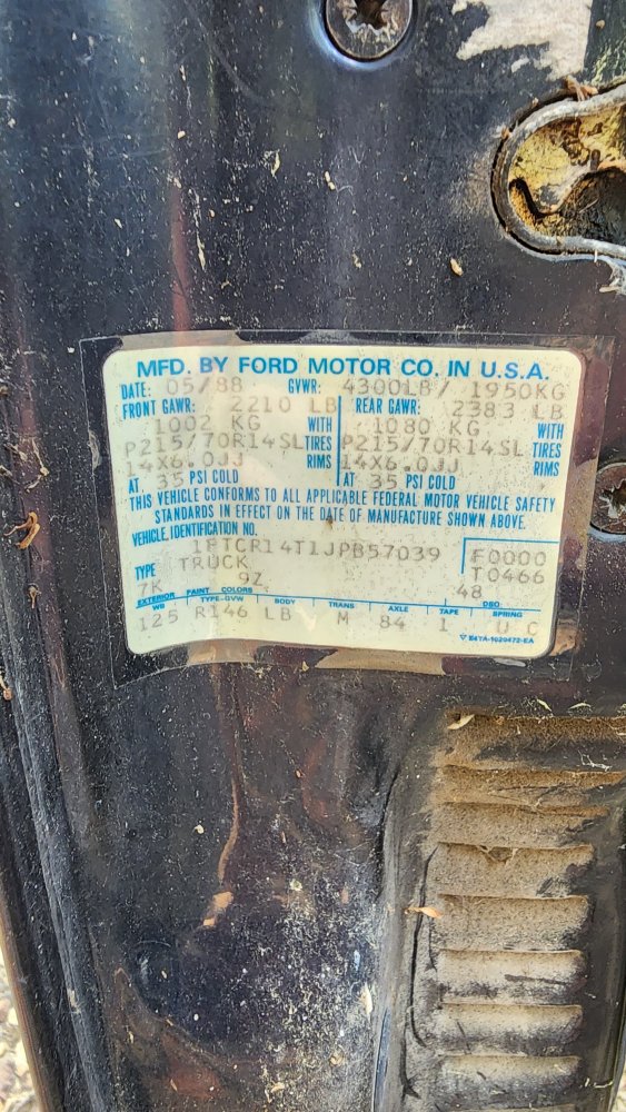

But I gotta confirm, are you just assuming the manual transmission you have is a M5OD or have you identified it as such from comparison pictures? '88 was the first year of the M5OD but was not common on 2.9L Rangers even through the last year of the 2.9 in '92...

I'm using the door sticker to determine the transmission. It is an M code transmission. I attached the door sticker.

"M" is the code for the M5OD. 2WD M5ODs built for the 2.9 are not common; so just be aware of that if you sell or trade it for a 4WD version, and don't just give it away.
The tech page I linked will give you better idea of the 2WD / 4WD difference, and also give you tips on visually confirming which model transmission you have.
With the M on the tag that's a good sign, like said, that's rare so why I was questioning :)
