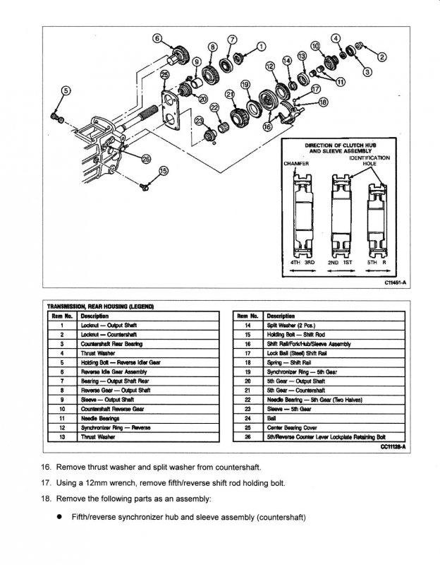

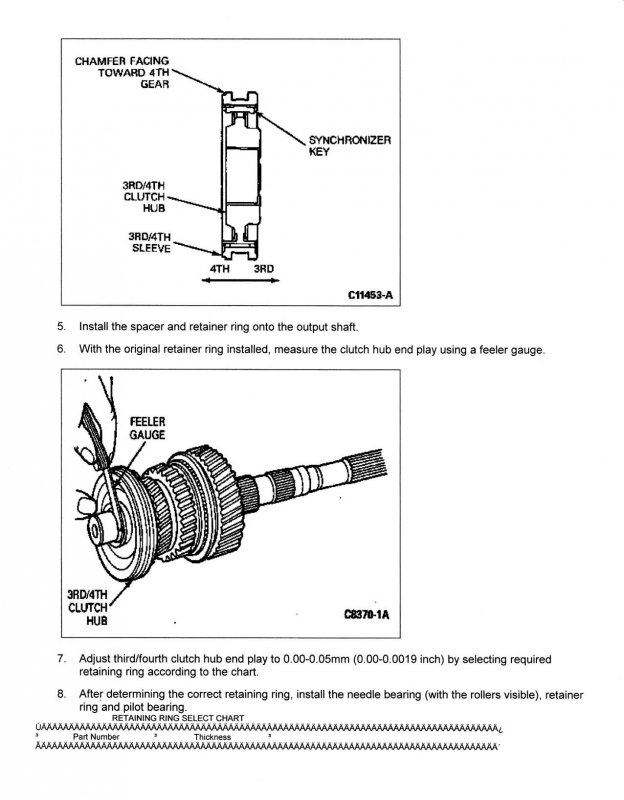

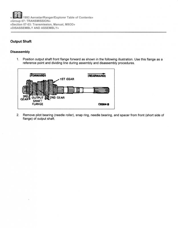

I have found it more than difficult to trace information on this topic that is comprehensive so decided to try this route. I know there are numerous others who have thought of doing this also, and had a hard time as well in knowing how to approach it.
There are also numerous others here who have have been around the block with it a dozen or even dozens of times. Your input here will be more than valuable to the success or failure of those us who do not really know the ropes in this procedure.
I'm offering here what I do have, which is merely technical data, in hopes of finding some practical knowledge to help those of us without it a better opportunity of clear this hurdle. Thank you all
Please note that the tech data is specific to the 93-94 models, I'm not sure exactly how many others they might apply to.

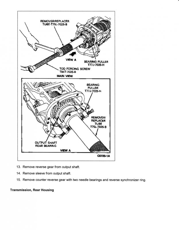

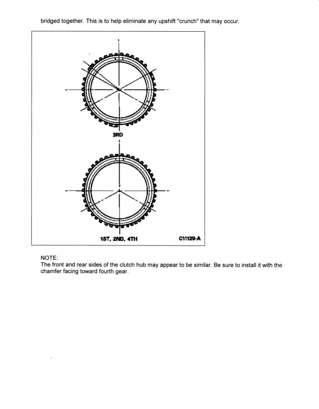

The following is for Disassembly and Assembly of the Shaft itself
30363
30364
30365
30366
30367
30368
30369
30371

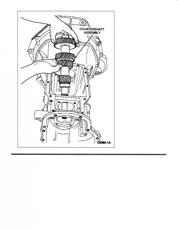

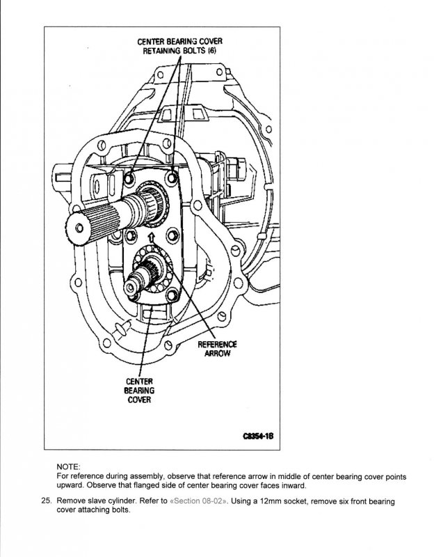

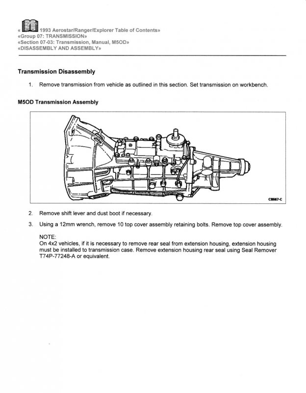

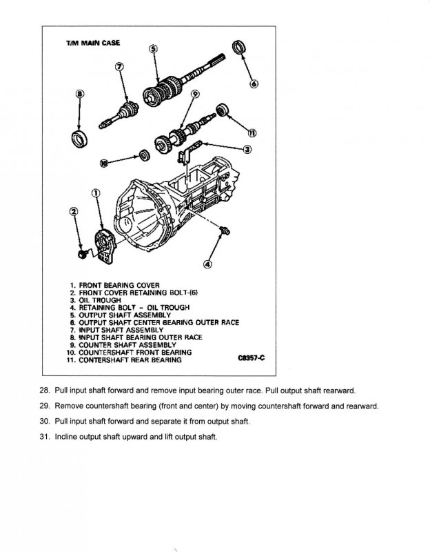

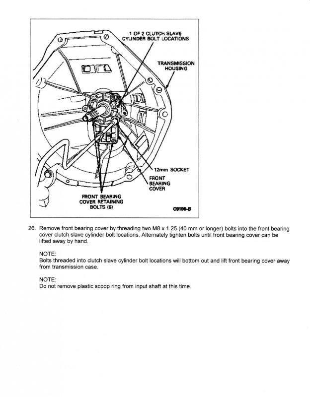

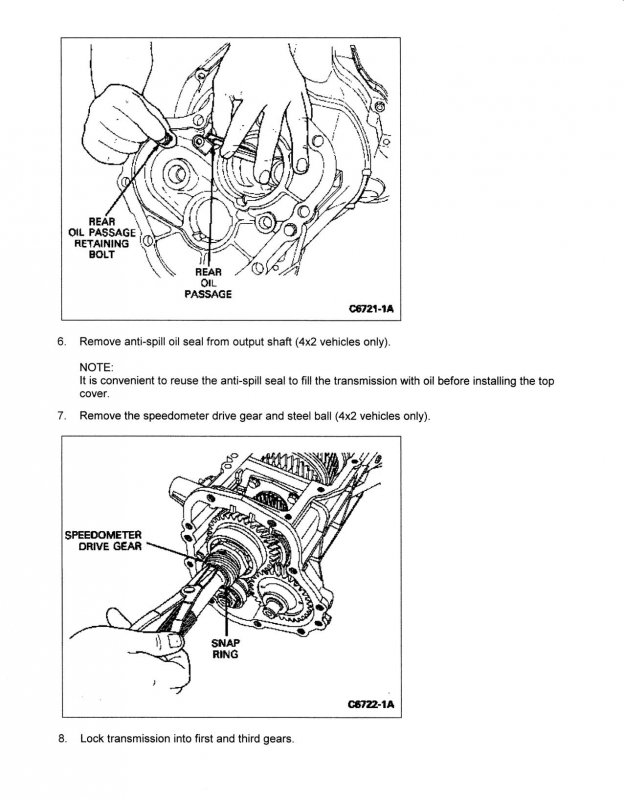

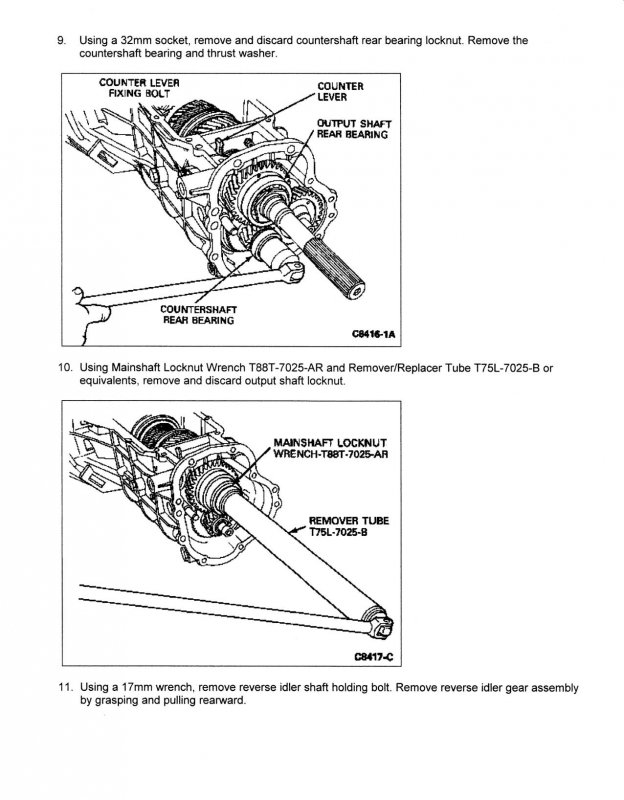

The following is how to get it out (takes almost entire disassembly of the Transmission
30372
30373
30374
30375
30376
30377
30378
30379
30380
30381
30382
30383
30384
30386
