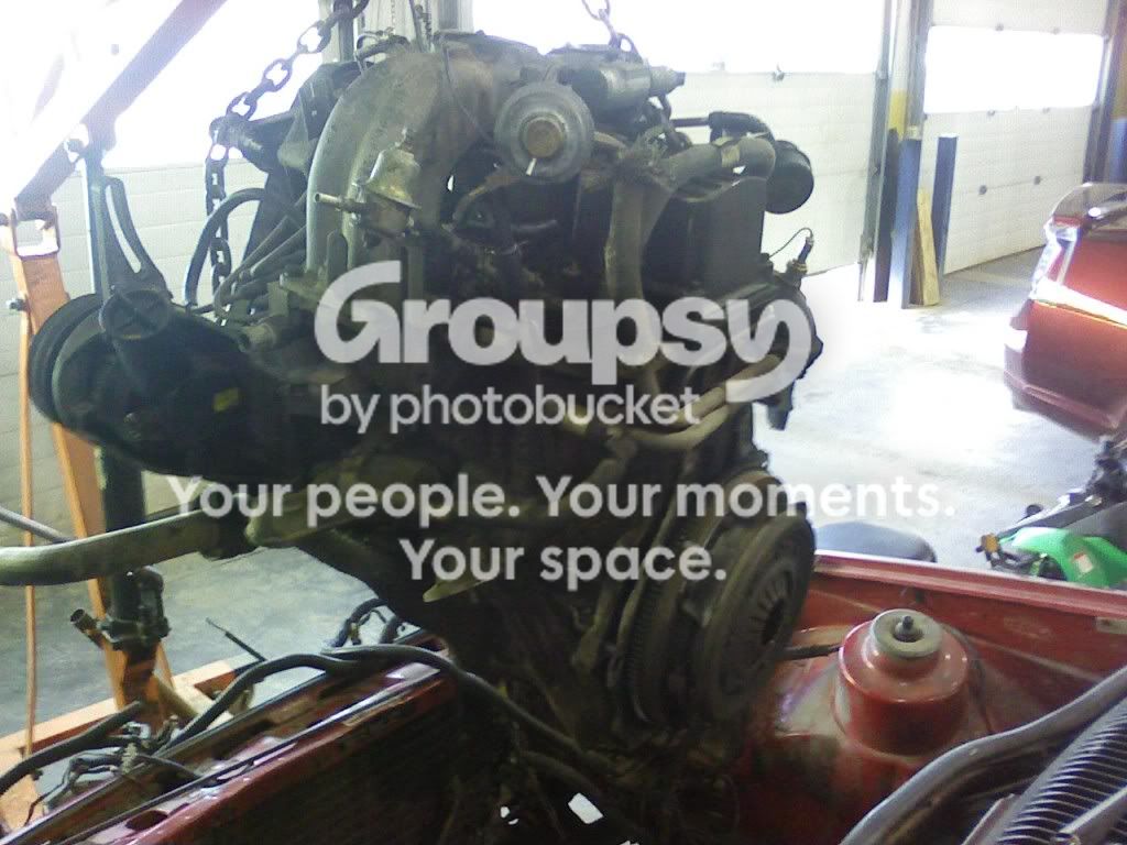

And now here is yet another legendary (Lmao) 2.3T lima engine, outta an 85 merkur xr4ti:
