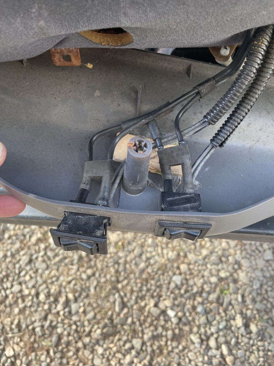

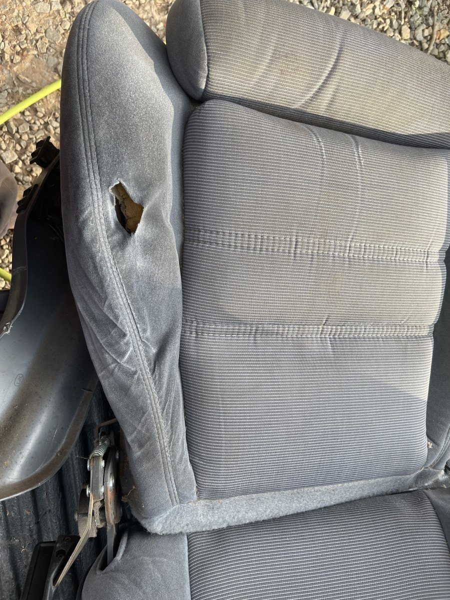

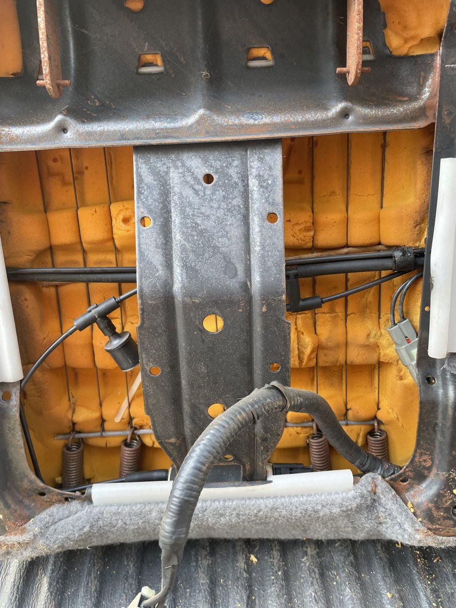

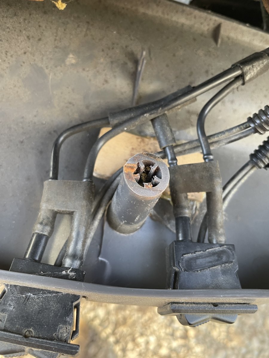

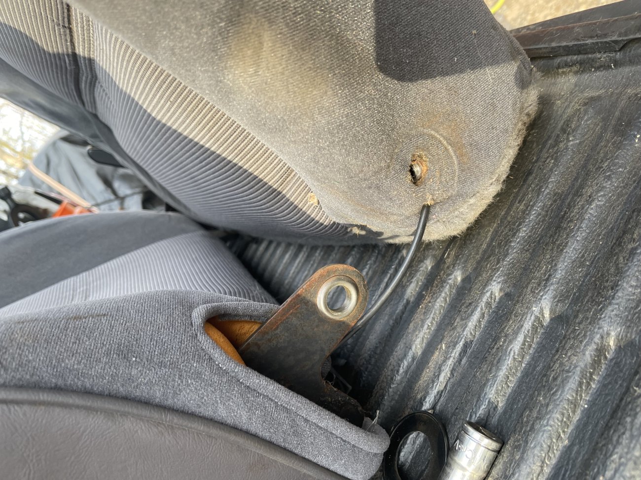

Replacing the left front seat lower cover.
Seat has lumbar, how do you properly disconnect the lumbar lines? Can’t find any plug in connections?

Looks like you just unplug the lines from the rubber pieces? It's just little air lines correct? You had better label them first.
It's just hard plastic air lines. But they can be difficult to disconnect. Try carefully heating them a little bit to soften the plastic
That’s exactly what I did, unplugged the lines from the rubber fitting and labeled the lines.
Thanks for the follow up, ppreciate it!
