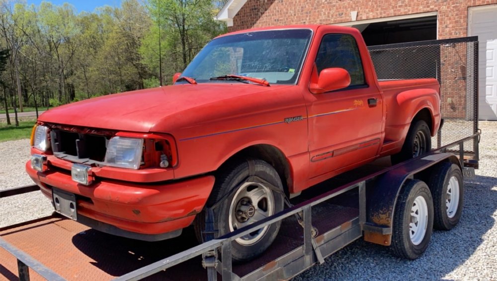

Hey I’m about to do a 5.3 swap in my 93 Splash. Was wondering what rearend set up you went with and if you have any pictures of it. Thanks in advance!

Hey I’m about to do a 5.3 swap in my 93 Splash. Was wondering what rearend set up you went with and if you have any pictures of it. Thanks in advance! View attachment 27221

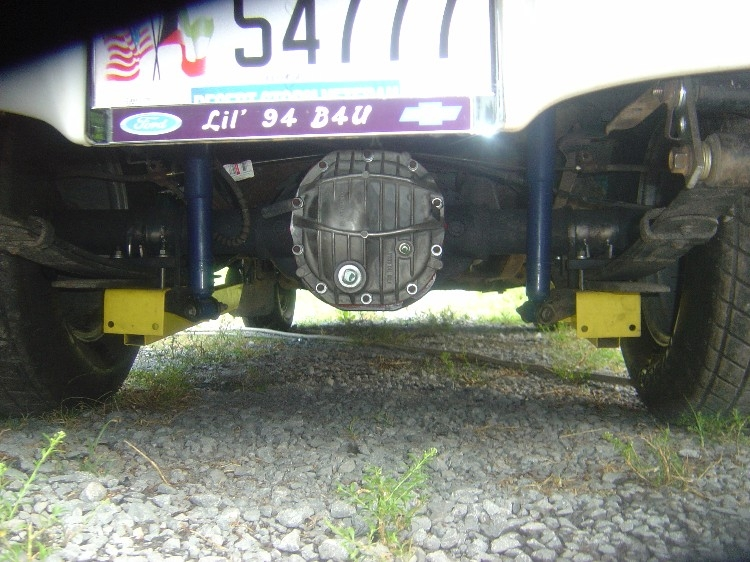

I just used a 8.8 from a 02 Mazda b4000.
Has 4.10s and mini spool I put a Perfect Launch diff cover with girdle.
Other than that its stock rear end don't have any pics since its nothing cool.

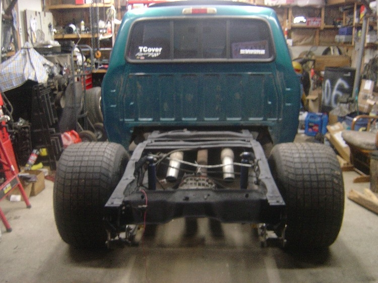

Well here's what I did with my lil' 94 back in 2010...........I narrowed my Explorer 8.8 L/S 3" then used 2 right side axles, & did the Explorer style (leafs under frame) mod......15X12 Draglites with 28X15.50 tires:
52486
52483
52485
It does have a fuel cell in the bed as the original tank is gone for room for suspension mod & 3" exhaust.
No mods to outer wheelwells.
I had to remove some of the support brace on the bottom of the box, but didn't have to tub it.
I used Explorer front spring hangers and made my rear shackle hangers. You will also have to make your upper shock mounting crossmember.
