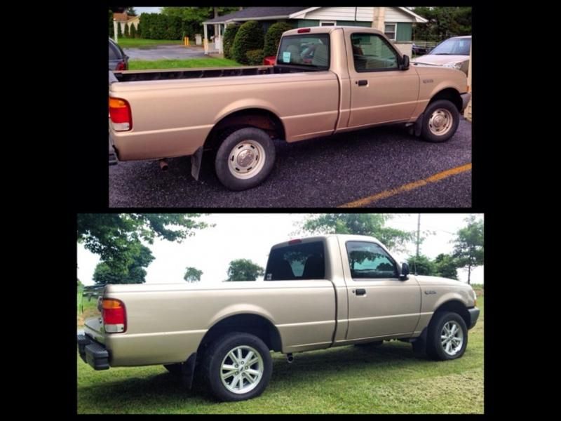

I got a 98 2wd longbed for cheap to haul stuff around my property and do odds and ends.. I am going to be doing the shackle hanger flip in the rear to lower the rear 2".. I also want to lower the front 2" and am looking into buying 2" western chassis coil springs..

Upper pic is when i got the truck. Lower is two weeks ago. Since then i have installed 2000 red tail lights and i have 06+ mirrors coming in the mail to install.
I found this pic of this tan ranger with pretty much the exact setup/ stance i want..
I am running 225/60/16 tires already with 1" spacers all around.
