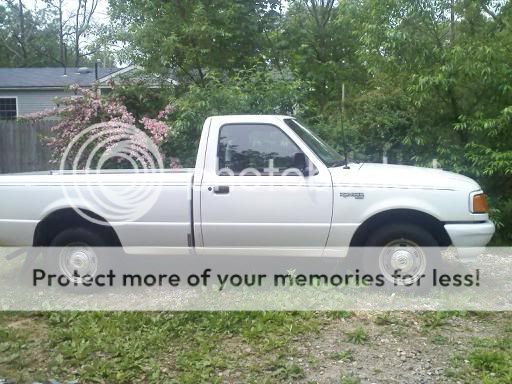

what is the best way to lower a 93 ranger on a budget?

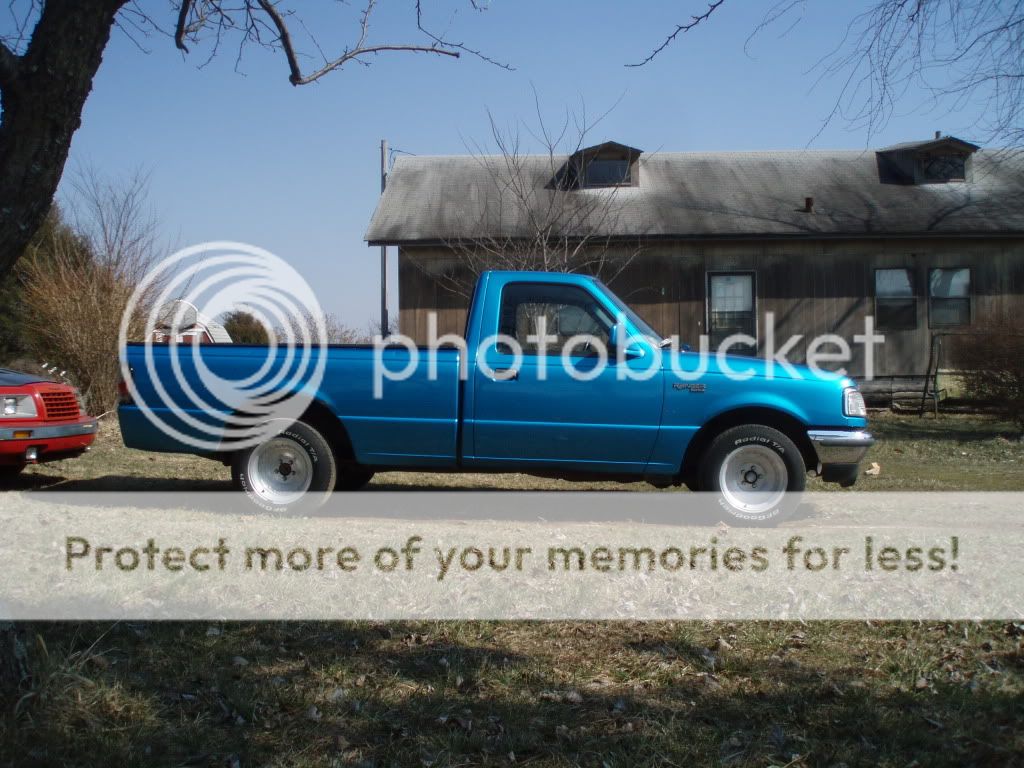

I did the shackle/hanger flip....was kinda fun!!!
Heres a pic of JUST a shackle flip.... only problem with pic is the ground is uneven... so pic is kinda useless...but truck initually had ALOT of rake....idk y.
0/2 drop
