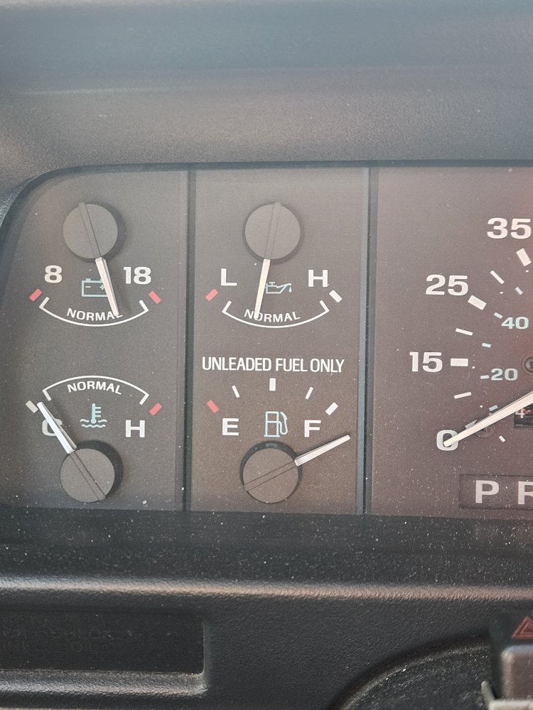

My oil pressure is running on the lower side of the needle gauge, its a little above the 1/4 mark on the gauge. I had changed the oil about 1k miles ago, I used 10w-40. My engine has about 142k miles. Is this normal to run a little lower on the oil pressure? Anything to be alarmed by it. I live in the East coast where it's cold, could the lower temps outside cause lower oil pressure.
That guage is a dummy guage.. as long as its not pegged on 0 your pressure is just fine.

Gauge issue.
Check the connection at the sending unit...make sure its clean and tight. If that dont work change the sender.
It only takes 3psi for the gauge to read "normal"...so it either will sit 100% normal or show zero. Anything else is eletrical or sensor related

My rules of thumb with oil pressure - a healthy engine should make about 10psi per 1000RPM, and if it's not making valve train noise, it's got at least some oil pressure.
Gauges in these trucks are funny. People wanted gauges to watch what's going on in their engines, so car makers added gauges, but people don't like to see any movement in them, which would be totally normal. Car makers then replaced gauges that were instantly accurate with ones that were not much more than a dummy light and people freak out that there's not enough movement. So we are stuck with what we have now... cars with a gas gauge and a speedometer and nothing else.

Please do not spend any time or money on what the stupid factory oil gauge says. If you want to spend some money, a set of aftermarket gauges hanging under the dash is a good investment.
This is the reading. I'm gonna check the oil in a few. Last time I checked it was full about a week ago... You never now.
Just checked, It's a quart low. I'll put some in, and see if the gauge reading changes.
Or just buy a gauge to test with. Often ground issues will throw off the dash...when in doubt test with a good gauge.
