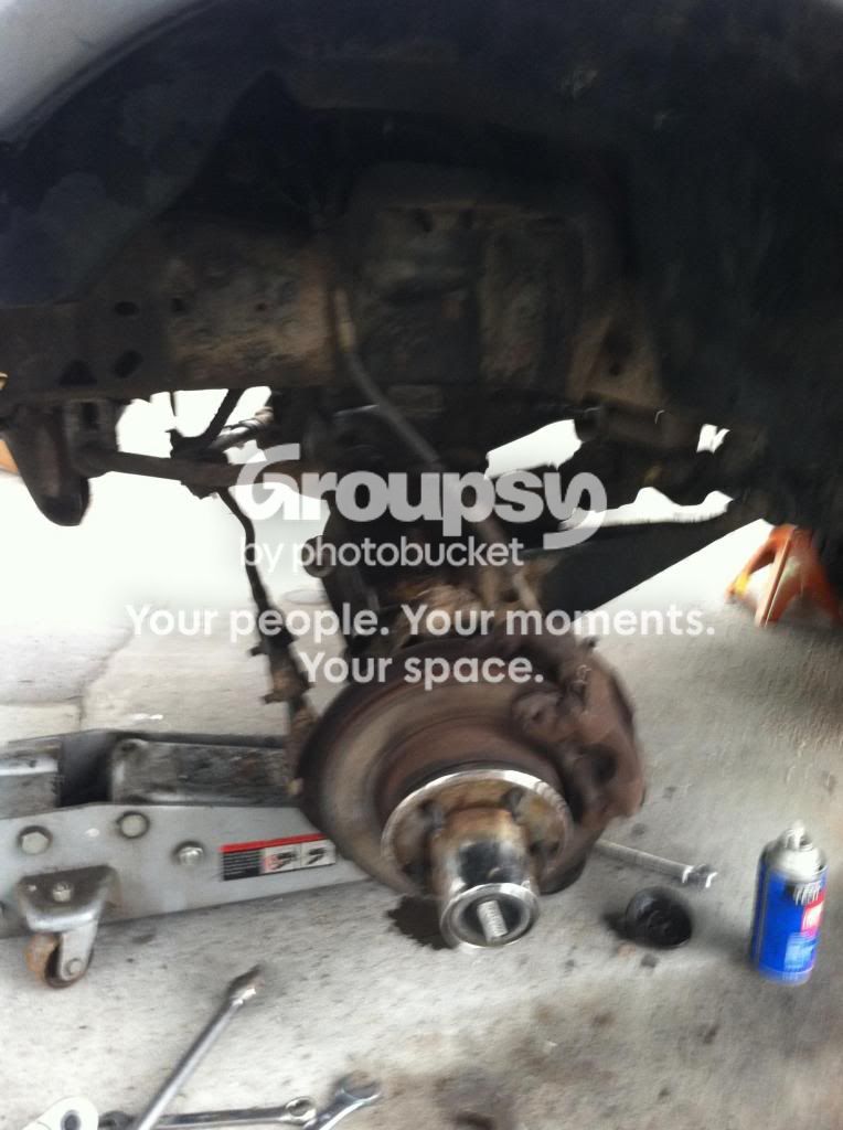

wasn't satisfied with the way the spring sat so I made a little piece to hold it back and tacked the spring in
