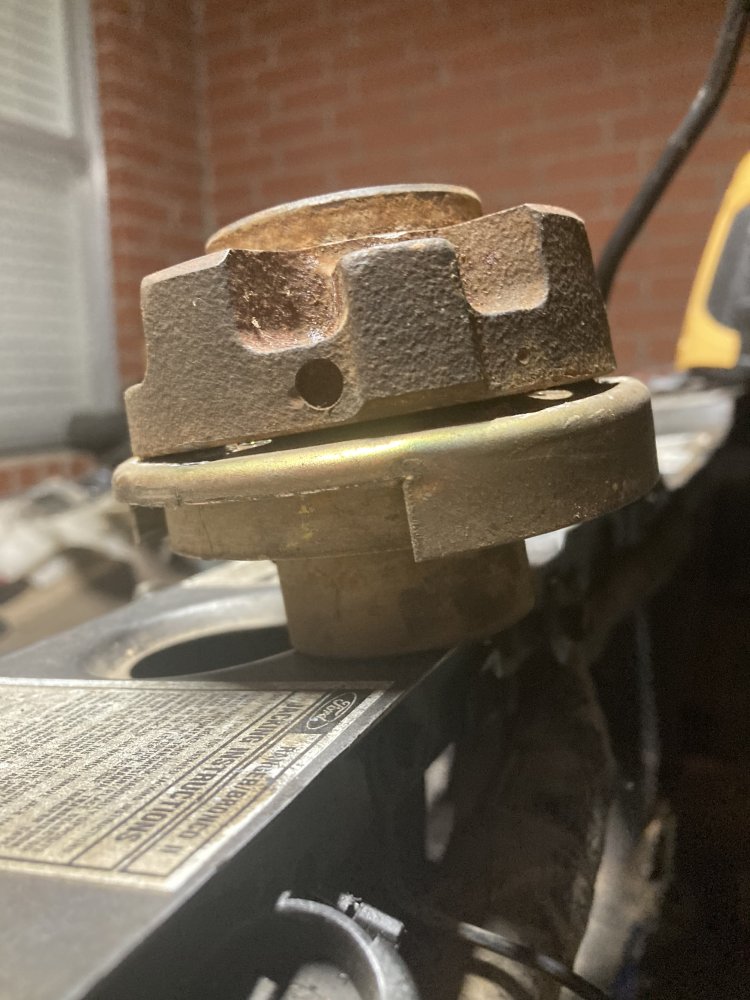

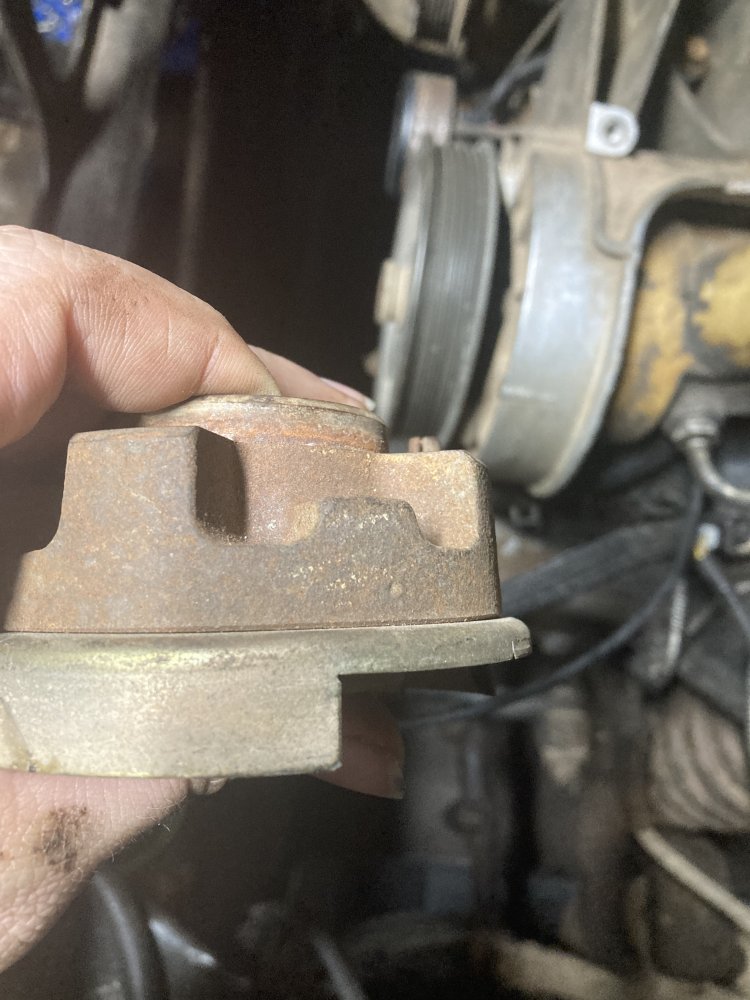

The harmonic balancer is slightly scraping the crank sensor, what should I do about that?

I understand that, but the actual harmonic balancer is bent slightly, so it’s scraping.

I’m really trying not to be smart ass here… if it’s bent and rubbing, then replace it.

If a part is broken, replace it or repair it

I’ll be replacing it this weekend if I can find one cheaper than 250$
How can a Harmonic balancer get bent?

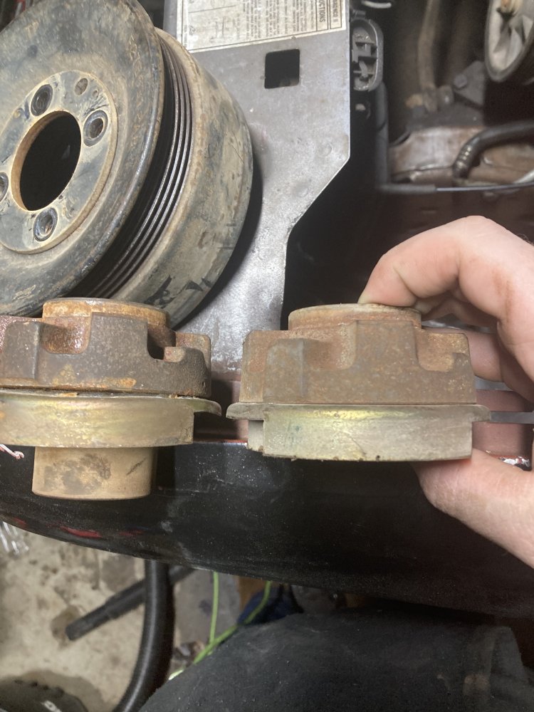

The one that snapped is the old one. Not bent at all, and there’s no gap between the pieces.
One I pulled off my old engine is the bent one. It’s got a gap between the pieces and that probably was one of the contributing issues to my old engine not running. That and having little to no compression on multiple cylinders.

I've just straightened those vanes in the past, works fine, all it has to do is pass through the gaps in the sensor and not hit the sensor, my calibrated eyeball has been good enough on the crank sensor so far and I've done some sketchy stuff with them, the '86 block I'm running now wasn't meant to run that crank sensor...

It broke the rivets…. Not sure how safe it’d be to run
