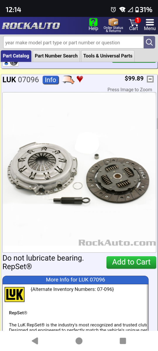

So coming home from work tonight I was 10 miles from my house and my truck made a loud bang. Went to down shift to 4th and it was like it was still in neutral came to a complete stop and I had no clutch pedal whatsoever. But if I sit there and pump the pedal I get clutch back but it's hard as heck to get in gear. Then I lose clutch pedal again Im going to say my throw out bearing went because it's been howling for a little bit now but I find it odd that I lost 4th gear also. Anyway I'm looking at getting everything Luk brand for clutch and slave and master but luk offers 2 different clutches which one is best to go with? And yall think Ill need to get a new transmission now?

I'm hoping my transmission is still good it always shifted good just find it weird I lost 4th when my slave cylinder went out but still have 1-3 and 5th and reverse. I can pump the clutch pedal and get pedal but but it's not pushing the pressure plate 100 percent which is causing it to grind going in gear
