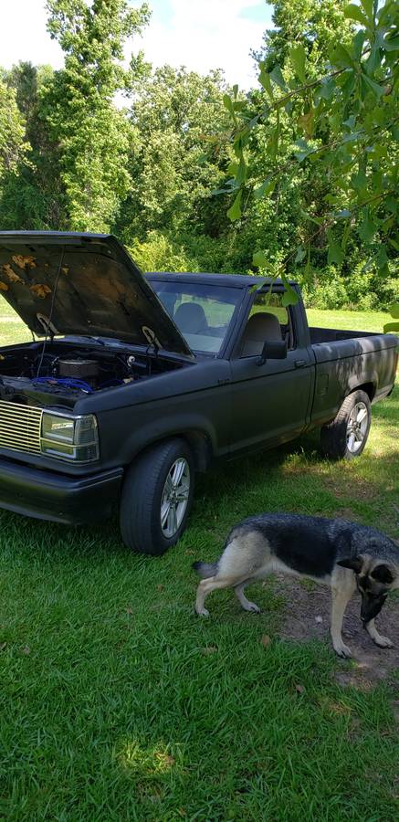

92 ford ranger - $4,500 (Milner)
92 ranger has 302 5speed truck type trans runs good drives good. I took it on trade it needs the motor mounts put in
it came with the mounts welded in but i have the mount kit for it. has custom grille and headlights new carpet. it will
need a battery . You can drive it home I'm looking for 4500 or obo or maybe trade for first gen mustang, falcon project text 770-298-602four no certified checks and someone will pick it up for you in person deal only
