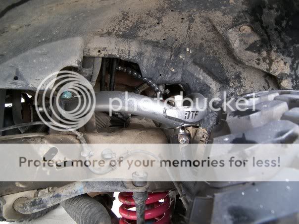

The Fabtech arms may or may not give you more travel. They look like they are stock length. If you want travel, you will have to go for long travel arms. But from what it seems, that may not be what you are looking for. I guess if you wanted to you could try the Fabtech arms to see if you got more travel with them. But otherwise, you should start looking for long travel arms.

the difference with the fabtech arms is that they ball joint is at a different angle so you can get more movement before the ball joints bind.that's what limits the suspension travel the most.

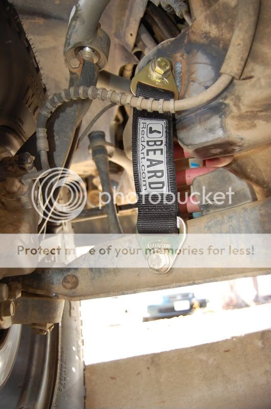

limit straps will help you a lot
