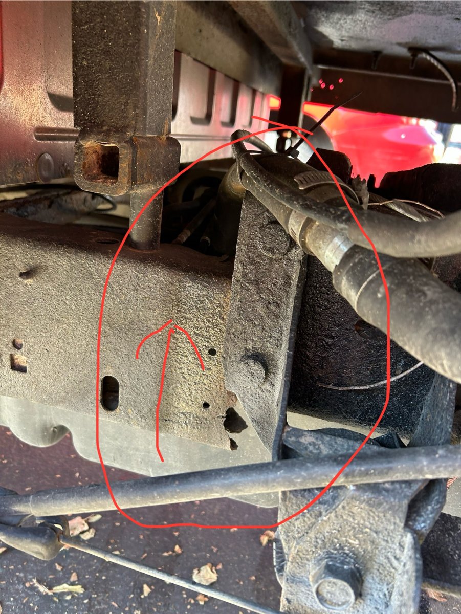

Unfortunately the frame on my Ranger recently broke. It was rusty and finally quit. The frame split right in front of the driverside leaf spring bolts.
I recently moved to Salt Lake City for my PhD and I just don't have the time or the money to learn how to weld.
I took it to a reputable body shop and they said there is nothing they can do. Junkyard is only offering me $340 for it.

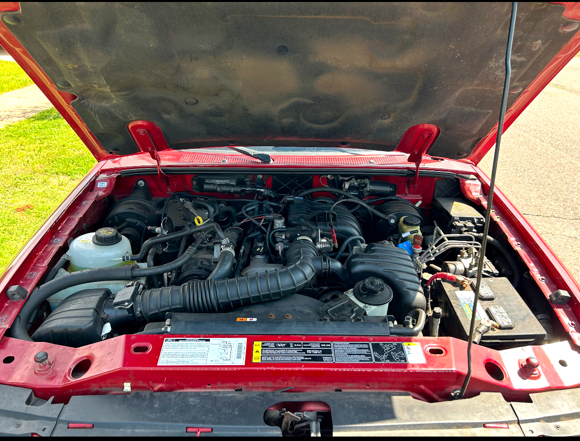

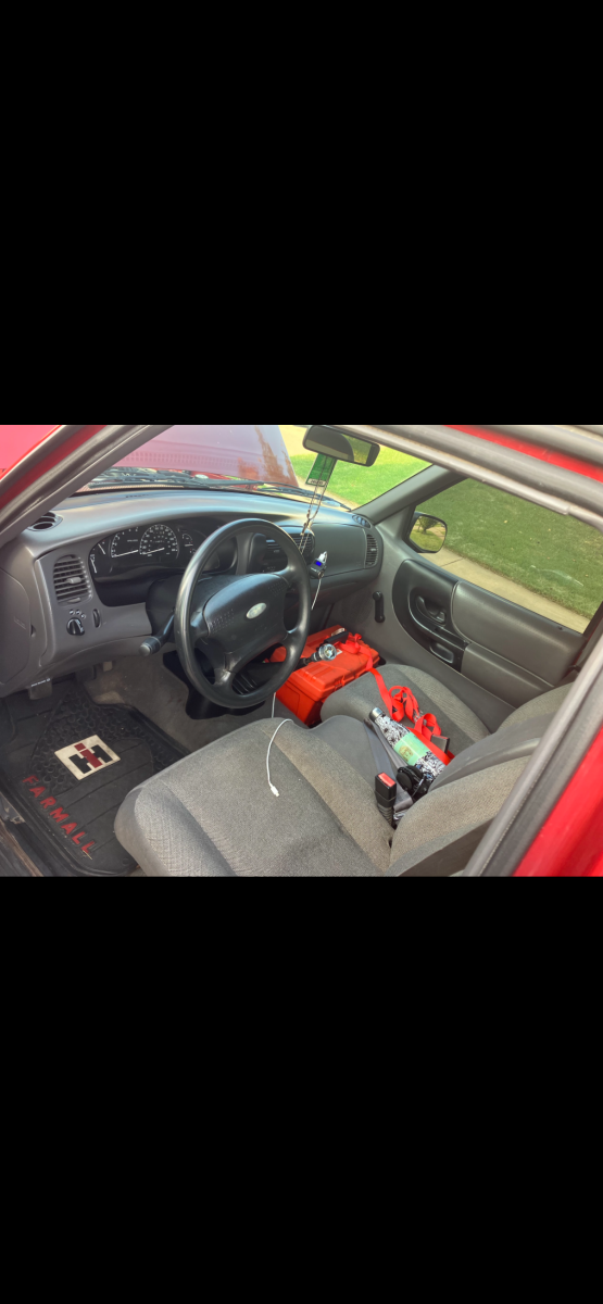

I've put a ton of work into the truck and about $1500 worth of parts. It's only got 127000 miles and the engine/transmission are great. The interior is almost perfect.

if i had to use it i would plate it....bridge it and get a few more miles out of it if it runs good.
no welding....just some drilling and hardware with 10 ga or 1/8 plate metal.
truck isnt worth anything, the time to part it out and how that is handled only you can figure.

I too would plate it, or go to a high school that has a VoAg/VoTech/welding might get someone who will weld it for little bit of nothing (materials)... less likely from a trade school... maybe even a Jr (2yr) college.
For liability I doubt a school will touch a truck frame. A lot of professional places won't touch one.

Frame breaks suck. Really wish Ford would have done like Toyota and sprung to replace frames since the 98+ frames seem to rot pretty easy.
I have temporarily bolted frames back together, happened with my green Ranger when I first got it, I was dealing with limited mobility because of an injury so it went up to my buddy’s place who knows mechanic work. Shock mount broke, but when he went to replace it for me he found the frame was bad. He can’t weld yet and didn’t have anything other than a little flux core welder anyway. So he bolted a piece of steel across the break until we could deal with the problem properly. I’ve done a lot of frame repairs since.
Unfortunately a bad frame ruins the value, a lot of people don’t know how to properly deal with it and a lot of shops won’t touch it.
