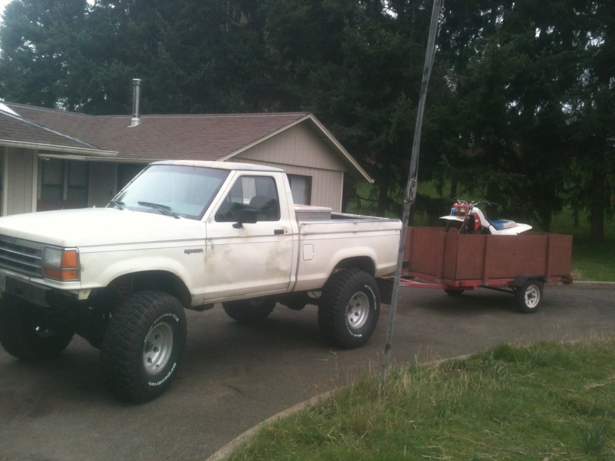

This is 6" suspension lift on my '90 with 35x12.50 BFG's (that measure about 34"). I did trim the fenders but just a little in all corners but folded the edges in so it's not near as noticeable at least when I did it..., I obviously have a custom front bumper so that doesn't interfere... I'm pretty sure it's mostly skyjacker, drop brackets are at least (they're pretty nice, look factoryish, not some truss system like SLA suspension lifts) and had to use blocks in the back because leaves weren't in the budget at the time (got everything used). I'm making longer radius arms now finally...
Your plan is good, should work out well.

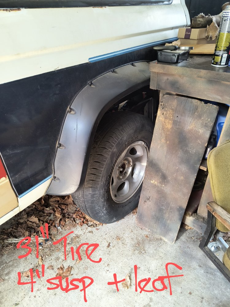

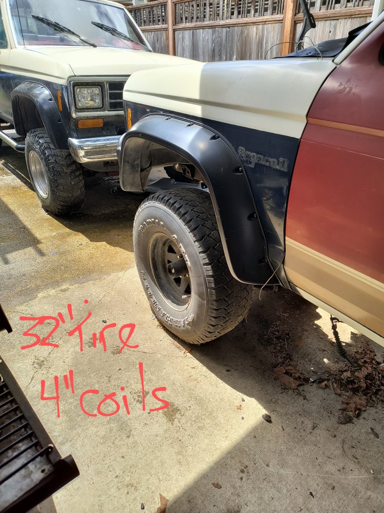

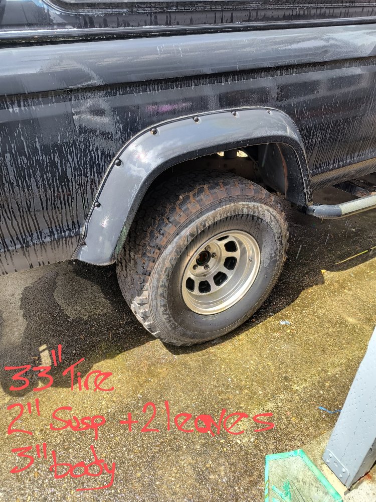

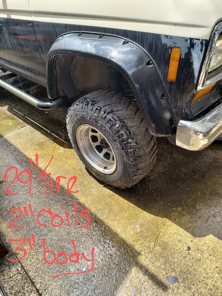

The 1st GeN wheel cutouts were designed for a 26" tire; I have to suggest a 4" lift with cutout fender flares. It is a two step work around but it avoids many of the pitfalls of both too large of rubber/lift.
I really like the look of a Ranger/BII with a 6" suspension but I chose what I believe is the path with less headaches...a 4" with cutout fender flares with 33" rubber. Another nice thing about a 4" is that Explorer packs, once flipped on top of the axle with just one extra leaf from the Ranger's original pack should have your rig right about where it should be to compliment the front with the 4" lift.
thats a nice looking truck! I like the Honda in the back also! appreciate the info :)

thank you for the info! would love to see some pics of your setup.

NOTE
Ranger pics are with bed near fully loaded+can O pee
