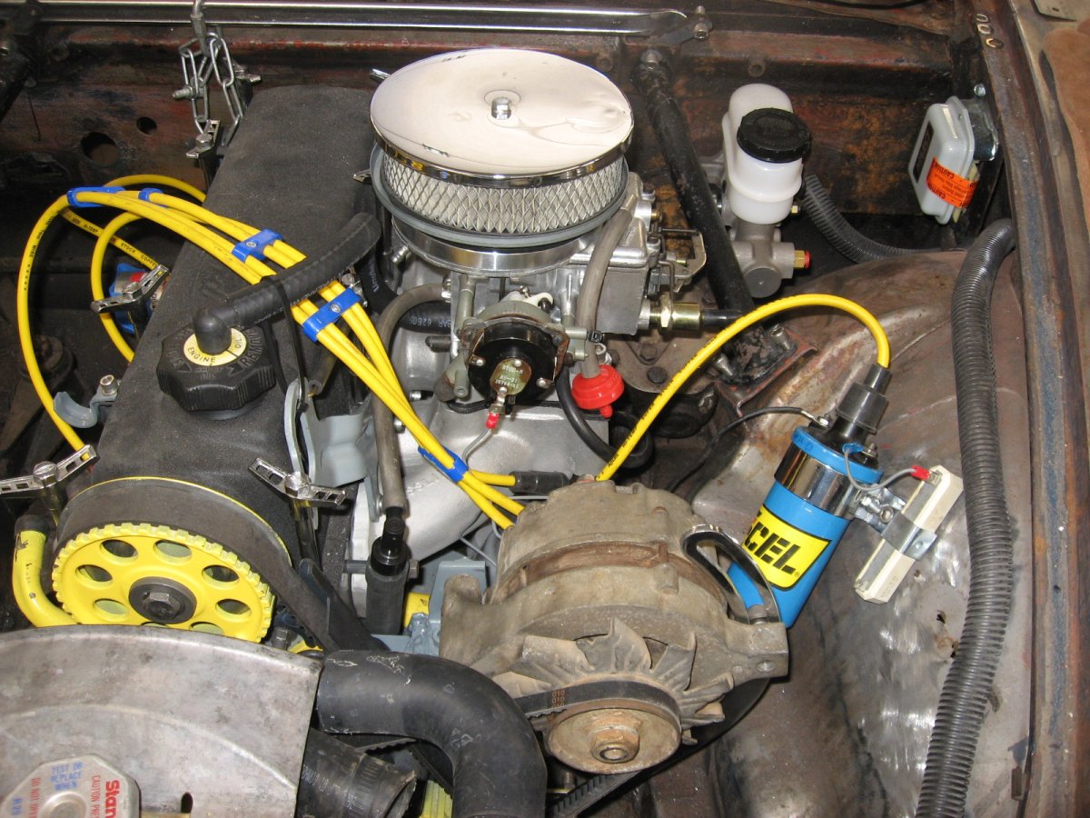

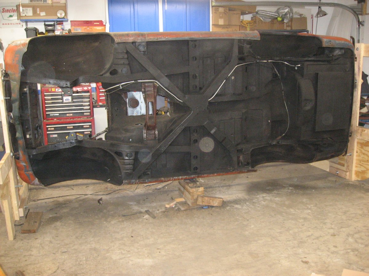

My 2011 Ranger with 2.3 has a column shifter but I have been told there is a floor shift for the A4LD, which is not in my Ranger, but I am installing one in a 2.3 powered 67 Sunbeam Alpine. A floor shifter would make installation much easier. Any suggestions appreciated.

In the pics he has a Lima already in the car so I don't think he's using the 2011 stuff...
