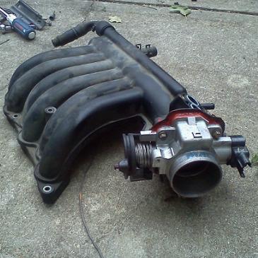

A larger throttle body is yet another option. There is a most intriguing and somewhat controversial article which can be read here.
The author clearly explains how to install a 60mm throttle body from an old Ford Escape. He claimed that performance was improved, but did not say how much. There were no before and after acceleration tests.
Some suggested that a larger throttle body can only do so much, that the Vulcan is limited.
Has anyone here tried this?

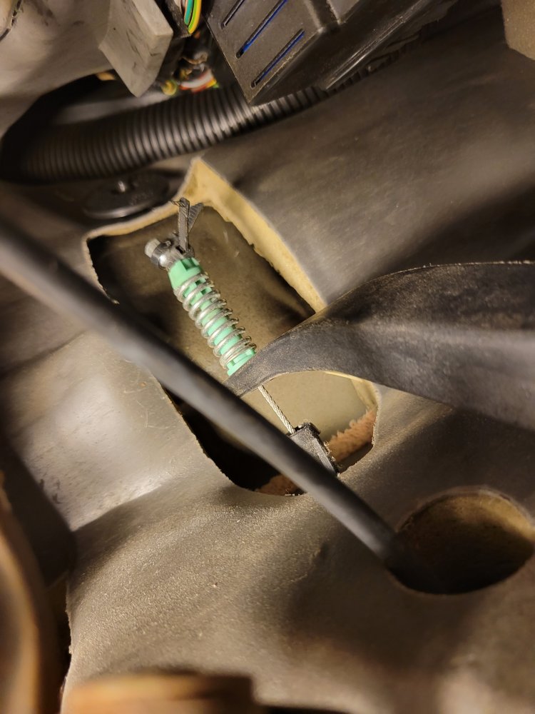

I just tightened up the accelerator cable by doing the zip tie trick. It is just one of many smaller changes. Now I can actually spin the oversize Cooper tires on my regular cab. The little Vulcan may never be a street rod, but it does have a little pep.
