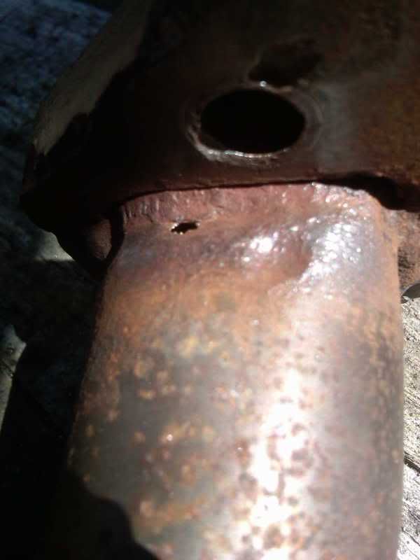

Don't be harsh now lol.
This shows what i started with, took the wire wheel to it and yeah it got larger a tad. Then Had to start a bead on the bottom and kept building it up, then ground it down some so i can still have adequate clearance for the header bolt head.
Eh......... looks about right. Mine would've been worse:icon_twisted:.
Flux core on thin metal or patching holes is veeeeeeeeery difficult. I think you pulled it off just fine. Function over looks! :D

And yeah its not pretty but it fixed the problem. I would have spent more time running a longer bead and ground it all smooth to blend but i found out quickly how easy it was to burn through the tubes even on a low setting haha. Got it remedied in the end though and i did it myself so im happy :D
