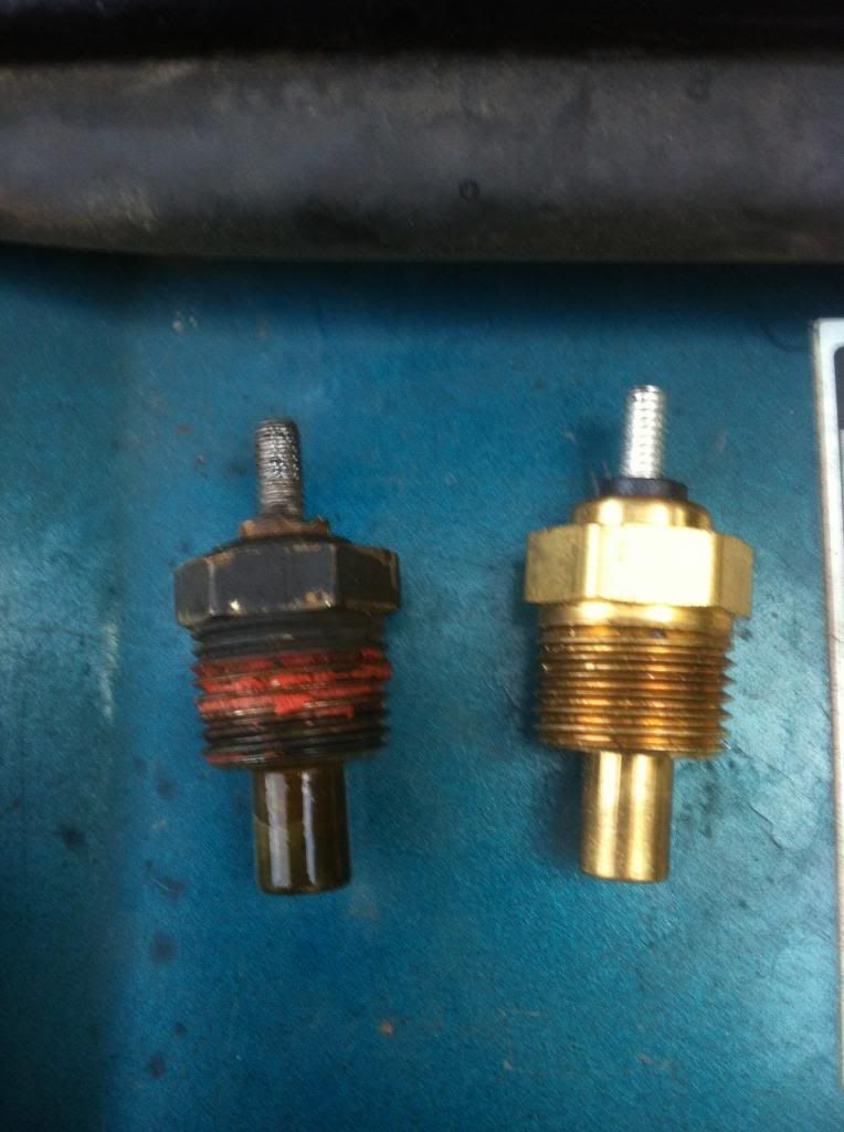

For your consideration: The location of gauge sensor for engine temp.
On 1992 Ranger 4.0L 4x4 supercab.
Manual has no info on where this thing is so I was looking in all the wrong places. Hope it helps future people. (Hello future people!)
Took the single wire off, shorted to ground and needle went to max- bad sensor. Likely just crud buildup.
Good, no electrical problems! :icon_thumby:
Out with the old- in with the new!
The gauge now works, but it never quite makes it even near the middle.. Maybe time for a new engine soon too as this one has pushrod tick to the extreme.
Any suggestions about that? Keep with the 4.0 or something else?
Try installing a new thermostat.
$8 well spent, since it regulates the temperature of the coolant that your new sensor is reporting.
If you don't want to spend the $8, slap a piece of cardboard in front of the radiator for a short drive. If the temp climbs higher, you can replace the thermostat with more confidence that it'll help.
4.0L is a good engine, unless you're trying to tow something you shouldn't be, I'd certainly keep/rebuild it.
Agreed, flush your cooling system out good and then put a new t-stat in (stock 190-195°).
