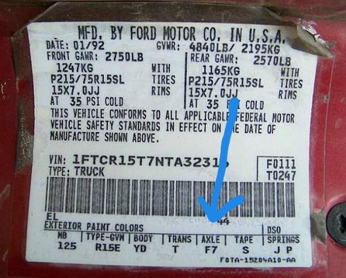

Can't find any info so I'll have to ask. 06. 4x4 4.0 8.8 rear with 4 10 gears. Nothing on the tag about limited slip. Is it or not? Will it hurt to add the modifier if its not an LS?
No, modifier won't hurt an open diff. You can find the axle information on the sticker on the door frame.
A 2006 8.8 with 4.10 limited slip would be listed as "R7".

All axle codes are listed here.
Mine has different numbers ajd its too late for me to remember right now. Lol I went ahead and put the modifier in. That thing is a thirsty bitch. 2 quarts and the modifier and its still low. Lol
