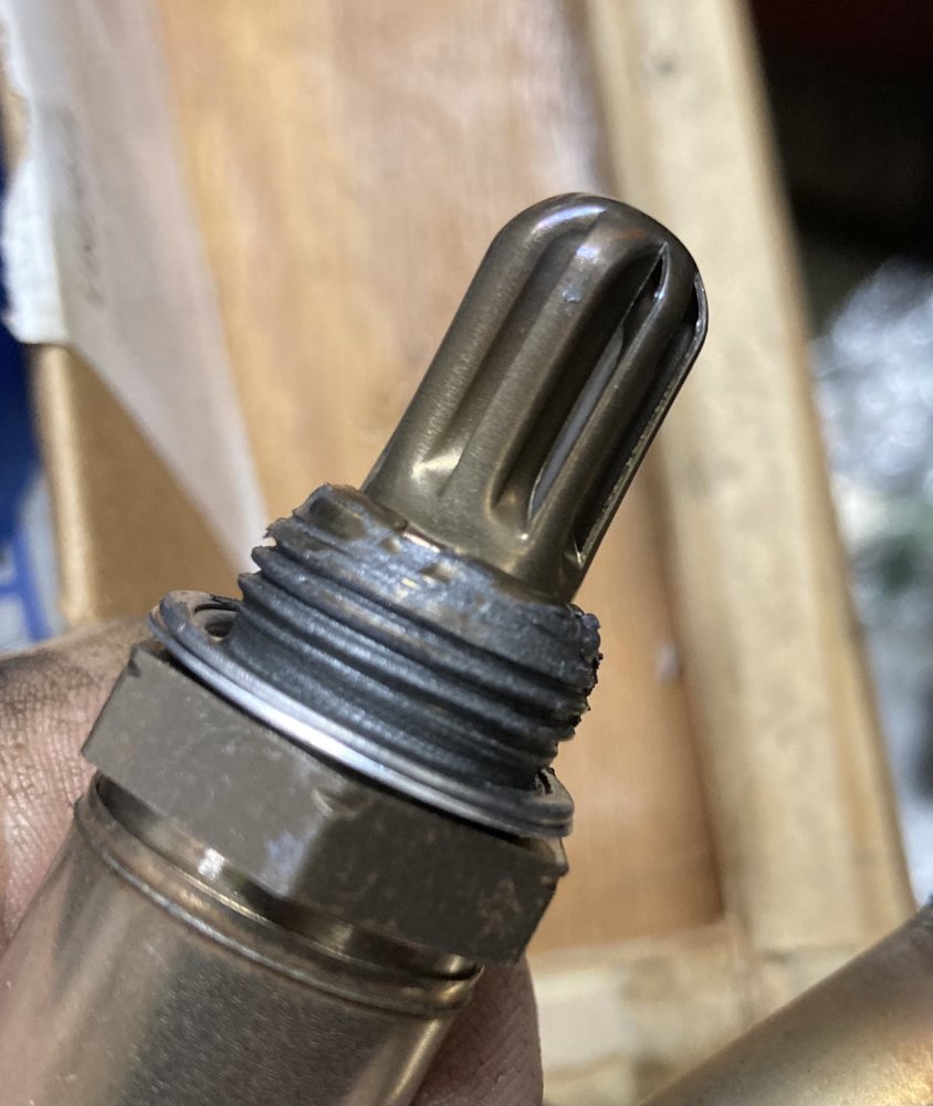

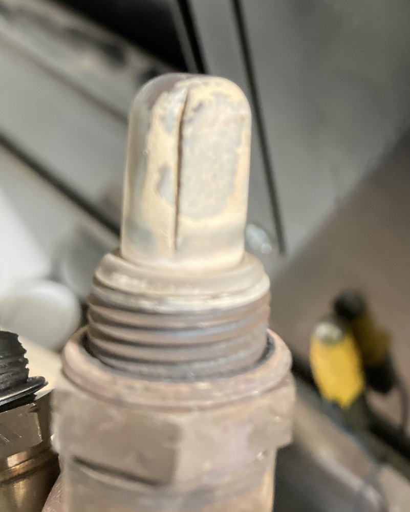

And the O2 sensor wins the event clearly!
Silicone poisoning!
The last owner used Blue "some kind of RTV" on all the intake flanges....... Why cant people just use good old gaskets and 3M Gorilla Snot?? I do... (did) on the thermostat housing and the IAT that I replaced (on the threads a taste).
Ill post pics, laptop feeling lazy about the cloud right now.
Clearly silicone. Matter of fact all the black soot leaks that were present at the headpipe (very light) are now burned off.
The car starts with no pop, at all.
The car when cold runs like its cold.
The car otherwise idles like a friggen baby (it was smooth but now its just a sewing machine), the low end torque is huge (low throttle, putting along at 1100 rpm in second), and that spot from 1700-2000 rpm, gone. In any gear at that rpm, lugging the engine uphill on no throttle, its just puts along. Extraordinary change in behvior. When fully heated its is just quiet and now has manors at low throttle positions.
The only exhaust note it has is the ridiculously short glass pack and turn down gurgling on decel, no BANG and gurgle or even multiple bangs. Or there is nothing but relatively quiet exhaust flow. Omg its awesome. My wife may just drive the car and not be embarrassed.
Forget the injectors and fuel pump....... its off the list. Night and Day change, took all of 10 mins after I found a 7/8 wrench.
And HE--- BUBBA-- didnt really use much torque on the sensor, Im sure it was leaking a bit from the signs on the crush washer.
Ill remedy the easily accessed headpipe and retorque tomorrow on a cool pipe.
$37 buck Walker Fix. Adios.
