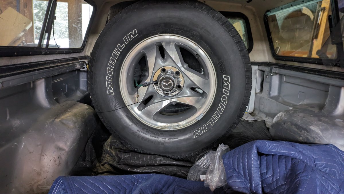

I did just buy these 16x7 Mazda OEM trispoke aluminum alloy wheels, with center caps! They were a good deal, but obviously not the lightest weight, and not the best size for an eco-focused mindset.
Lightweight, thin, economical wheel and tire recommendations.
I am partial to working with them strictly because I already have them, and they’ve got the Mazda drip, but if others can recommend 15x6-7 wheels that are lightweight and affordable I may consider them as well.

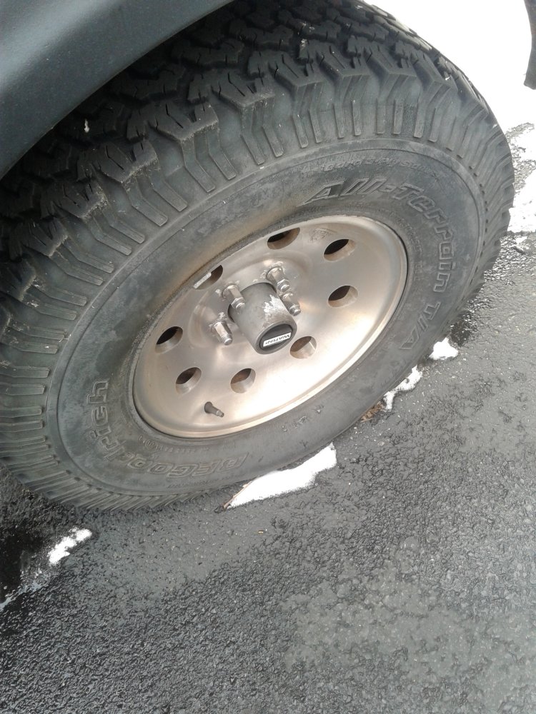

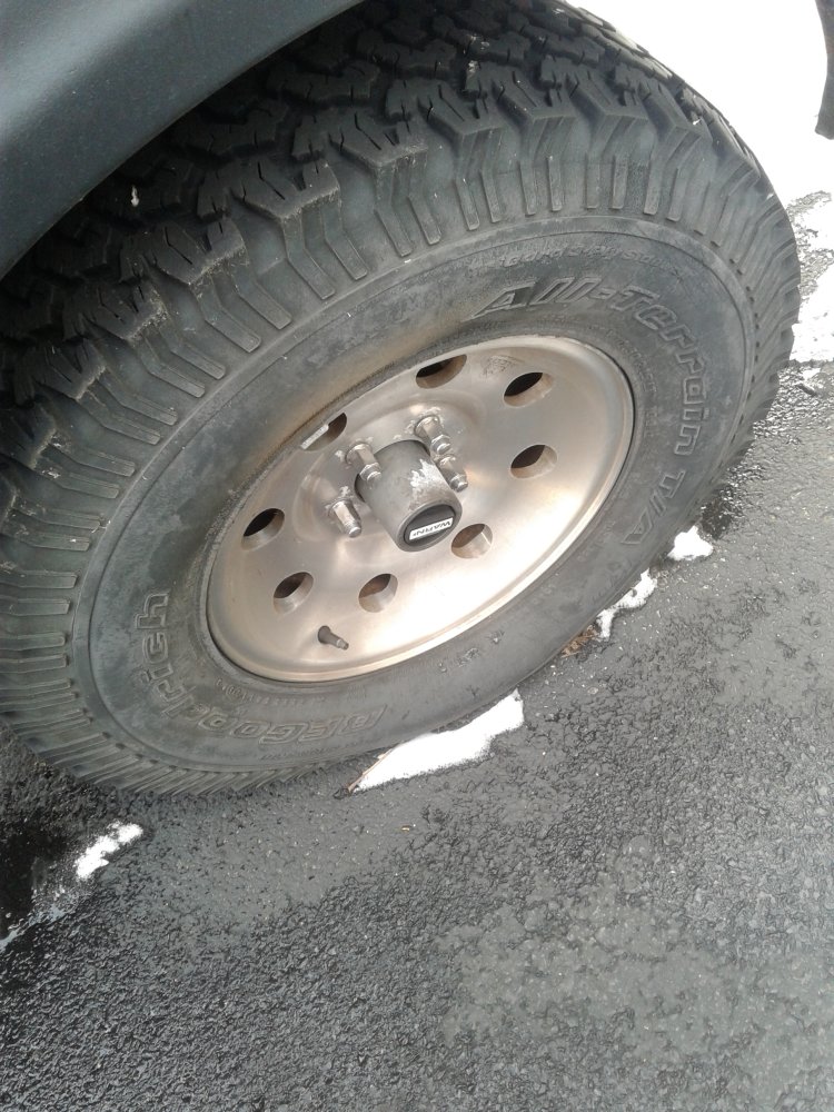

I would say find out if those 14s from the gen 1s fit and then you can get an 85 series sidewall and a 185 or 195 wide tread tire. You would get really thin and lots of sidewall that way and tires were only 47 dollars each when i got some a few years ago.
Those 14s look like the alcoas above

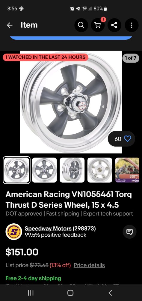

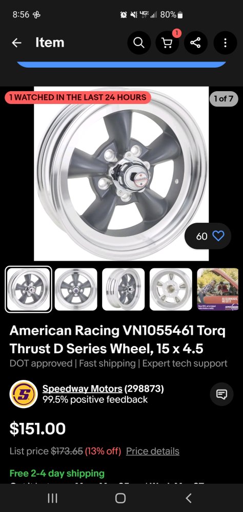

A set of these wrapped in 185/80s
You need to re-think your sizing. The aluminum wheel is much lighter than the rubber tire. So more wheel, less tire would make the assembly lighter.
With 10 plys this can be the case.. usually not with p ply cases though
I was considering ordering these because I know they're lightweight, but unfortunately I can't find a set in Canada that either fits a reasonable tire selection, (finding 185/80 tires is basically impossible) and doesn't cost an exorbitant amount of money.
I did almost order a set of American Racing Outlaw 2s as they're pretty lightweight and were available, but then I found the vision 55 Rally wheels which were about the same weight, and significantly cheaper.
