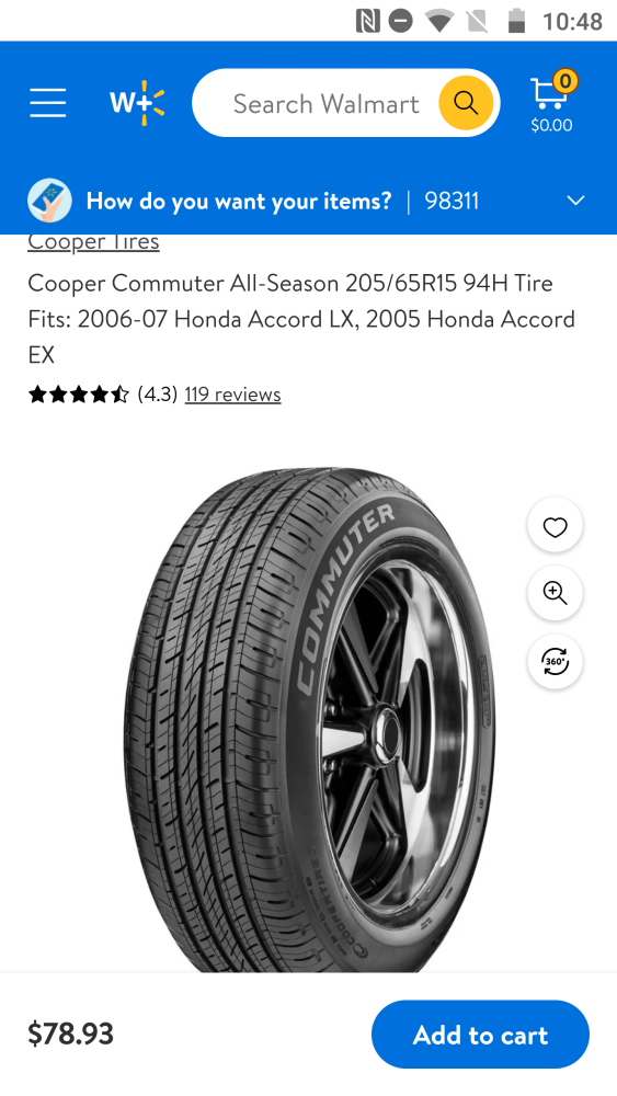

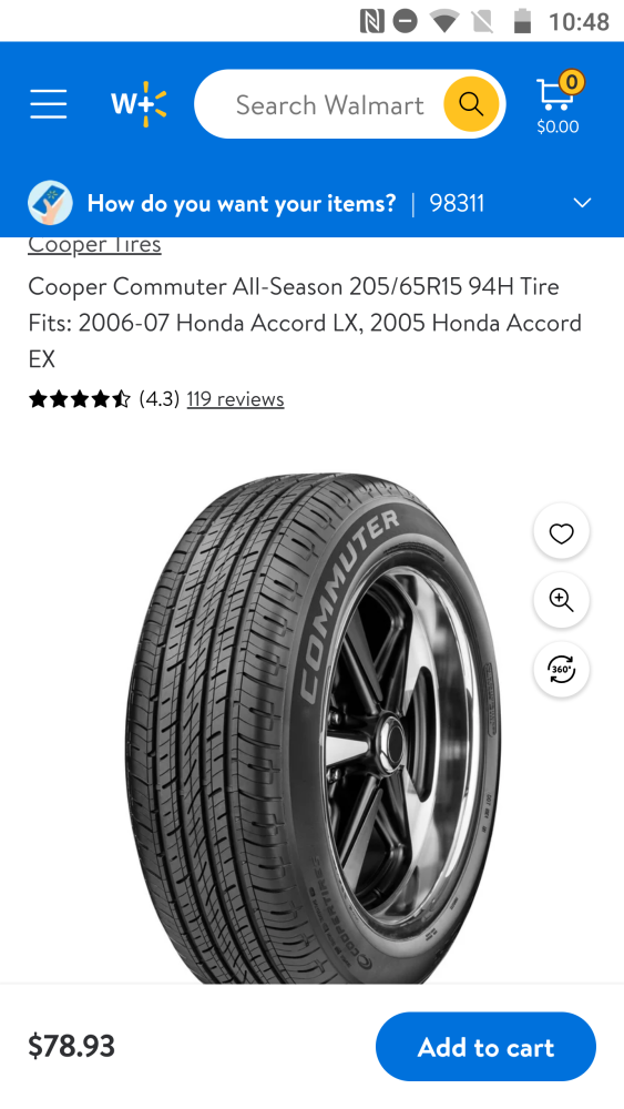

@bhgl
These are almost the size that came stock on both my rigs. Screaming deal @$79 EACH!! Though I would not consider them with other than a 3.42 or lower gear ratio.

@bhgl
Regrettably in this situation, I'm Canadian! So by the time they reach my side of the border I'll be up shit creek in duties and shipping.
